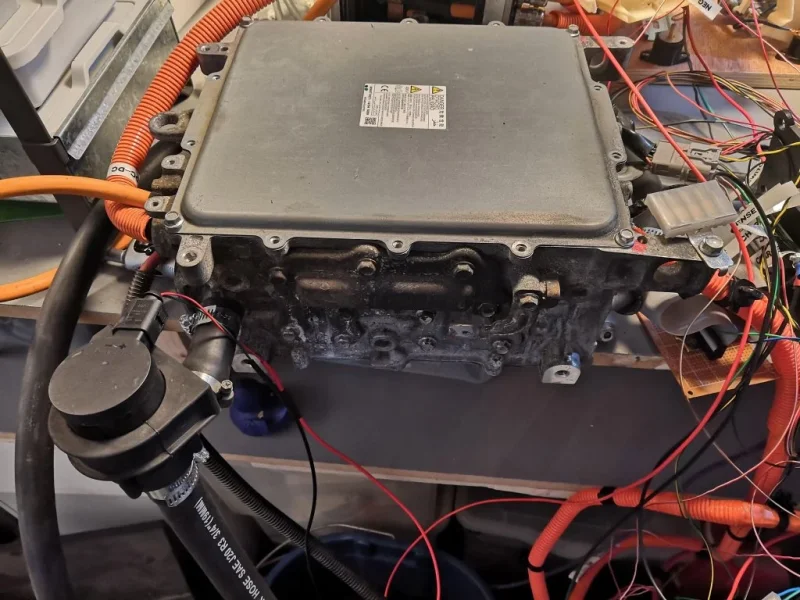

It has been a while since my last update. My inverter control board was off getting repaired, the cold weather, rain and snow made outdoor work either unsafe or unappealing, and right up until the break I was buried with work. But getting there again now.
With everything else ruled out I decided to focus on my battery pack and charging. If you've been following this build blog you'll know I had SimpBMS running on a Teensy 3.2 to manage the batteries (5 cells from a BMW 330e hybrid) and a 3.7kw charger from a Mitsubishi Outlander PHEV (same as my motor). Since the last update I picked up a cheap Pod Point Type 1 charging point (£60 from Facebook) which doesn't have huge capacity but matches the charger. I had planned to modify the BMS (battery management system) software to control the charging but this required a bit more work than I realised. So in the short term I decided to experiment with a sketch for the Arduino Due shared by one of the OpenInverter forum members also playing with the Outlander charger.

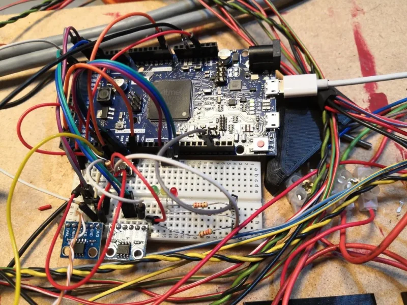

This sketch has three inputs and one output. It pulls information from the charger over CAN about the battery voltage, AC etc. It connects to the PP (proximity pilot) pin of the charging port via a voltage divider. And it has a push button.
The charger itself connects to the other signalling pin from the charging port (I picked one of these up, also from an Outlander). When you plug in the charger, the Arduino sketch recognises that is plugged in and sends messages over CAN to the charger to tell it to start charging, and sets a target voltage.
I had a bunch of problems getting this all working. My charging handle had a lower resistance on the PP line than the person who wrote the sketch, so pulled the input pin to a level where the sketch went into an error state. The CAN transceiver I used received messages fine but refused to send them - I had to swap it out. But after some messing around there were some satisfying relay clunks and the system started charging.
I then started to look at the BMS and had to work out how to put it manually into the mode where it would monitor charging. There is a digital input for this which puts the sketch into the right state when pulled high, so it was just a question of identifying this from the code (pin 18 in this case).
With the BMS in charging mode I could monitor the voltage on my battery slowly climbing - I was limiting charging current to 1A out of a maximum of 15 since I didn't have any cooling hooked up to the charger or the batteries.
After a while the charger did get a little warm but everything was clearly working so I turned it off until I could add some cooling in. The batteries seemed to be absolutely fine so I just added a pump and a bucket of water to the charger for now. After an initial small leak, this worked fine with some tightened hose clamps.

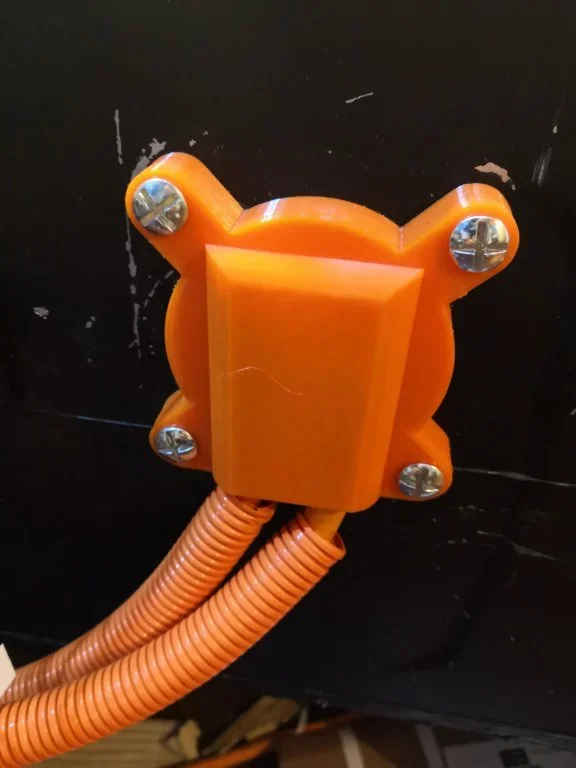

  • Redesigned and reprinted the battery box connector to make it much simpler and more robust - see image below

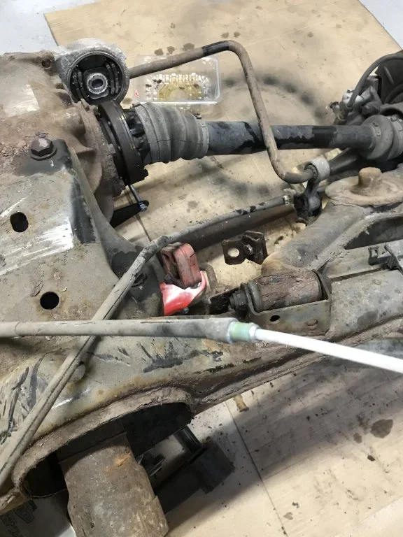

  • Made some progress removing the rear subframe. All the brake lines had to be cut because the unions were completely seized but the handbrake cables are now out and I'm down to three very crusty allen-head bolts that don't want to move. They have been repeatedly soaked in WD-40 and cleaned with a wire brush. Next step when it's a bit drier and warmer is a few smacks with the hammer and maybe an assault with the new impact wrench.

Some tips for getting Allen bolts out
1. Always have a spare bit of the correct size, amazing how many snap just before the last bolt.
2. Give the bit holder a really good few smacks with a hammer before you attemput to remove it.
3. If the inside rounds, or, is already chewed up, smack a splined bit in. Consider the splines/torx bit sacrificial, seldom get it back in one piece.
4. If it's really toast, clean it up as best you can, pop a nut over the top and weld together. The heat will usually get it loose.
Also works well for bleed nipples.
Thanks Iain. Hoping to avoid the welder or any heat given proximity to the fuel tank and severed fuel lines, even if the tank is drained and the fuel lines clamped. But the hammer is definitely going to see some service and I fear I will have to at least sacrifice a splined bit on one of them. We shall see when time and weather permit. Really should have done this job in the summer!
Another option for removing rounded Allen bolts is this tool from Irwin, Tom. (there are other brands out there now but these were the first I came across).
I quite like those for standard hex Tony, any time I've used them on Allen bolts I've ended up with a mess. Probably more the poor quality of the (usually) Japanese fasteners.
Tom, if you have to revert to to the welder, screen the pipes/tank as much as possible, carboard/plastic anything really, and turn the gas right up. I typically used 20-25 litres and run it a bit hot. If your welder has a progressive trigger where you can get a some gas that's a help.

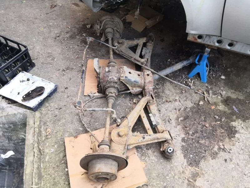

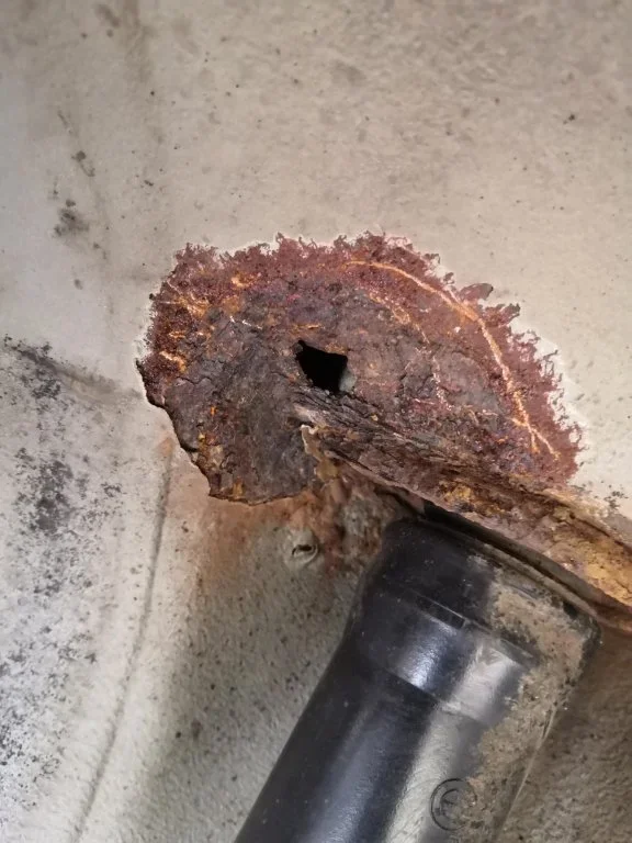

Yesterday: JFDI
Today: Just f**kin' did it.
Three drill bits, two different bolt extractor tools, two blow torches, an angle grinder, a hammer, a power drill, and an impact wrench. Oh, and a lot of swearing. But I got there.
Needs a good clean but despite all the crust, I don't think there's anything structurally wrong. Not liking the prices of new bushes though.

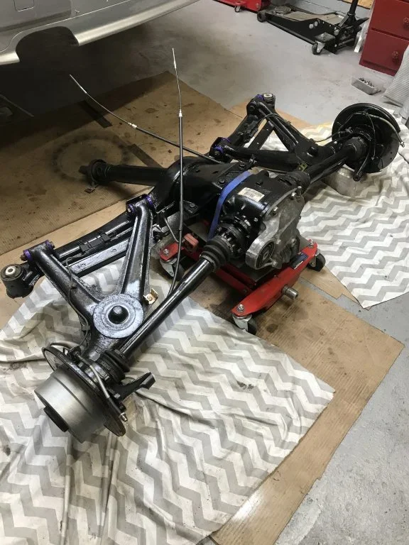

Doesn’t look too bad, taken a couple out that look similar and they clean up ok. Keep the faith!
Believe it or not, that’s not bad.
son and I have done a couple of Mini, bits of those were quite terrifying.
There are 3 ways of piecing metal in
Butt welding. Just don’t, it’s not for beginners
Putting a flange in the panel and letting metal in. Not as easy as it sounds.
Putting a flange in the repair panel and welding it in. The most fiddly, but by far the easiest.
back in a minute, a cat is demanding to be fed.
Little monster clearly couldn’t catch a rabbit tonight.
Right Tom, attack that with a wire brush or a flap disc to get to wherever decent metal is. Mark with a sharpie, overlay a piece of baking paper, it’s semi transparent, mark the paper. Now you need a flanger/edge setting tool/joggler.
Find out what depth the tool puts the flange with a piece of scrap metal.
Subtract 3mm from that depth and add it to the baking paper pattern. Lay it on a piece of steel and cut it out. Now, flange it, so that the flange goes on the INSIDE. Fiddly to get in place. And you’re now thinking “bugger, that’s too small, there’s a big step”. No it’s not, the step is where you’re going to weld, that makes it almost invisible with just a quick touch of a flap disc. You can rivet it in place, use magnets, but the best are Cleco pins, temporary rivets.
I can lend you that stuff.
If the rust goes under the return I’d do that in two pieces, bending a curve is difficult, welding it from two pieces is easy.
