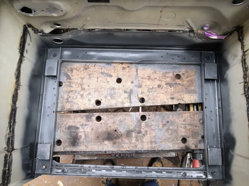

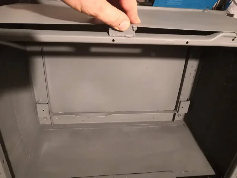

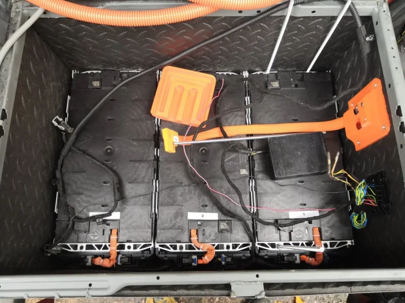

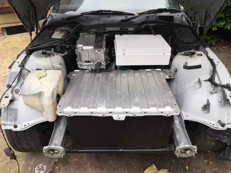

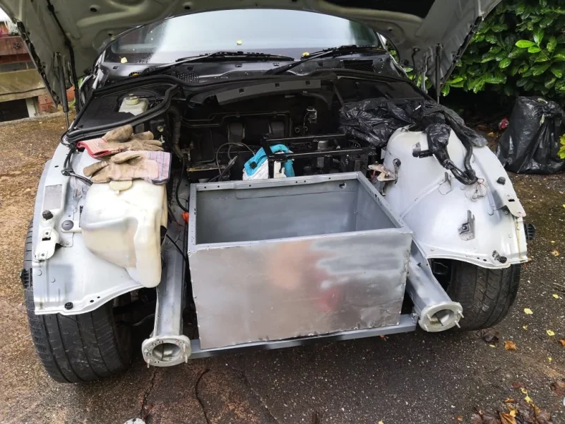

Battery Box
After my disastrous spatial miscalculations of the last update, I decided I wouldn't try fitting anything else until the battery box was actually done. This has taken a lot longer than expected. For a start, I needed more steel than I thought to get a properly sealed box all the way around. One of the washing machine panels I was going to use bowed out at the top and trying to rejoin it to the frame in a way that made sense was just too much work. So I cut it off and replaced it with a fresh piece of steel, as well as adding one to the bottom, and a patch to the back to make it nice and square all round. The welding isn't exactly pretty but I'm slowly getting more consistent and only occasionally forgetting to turn the gas on.

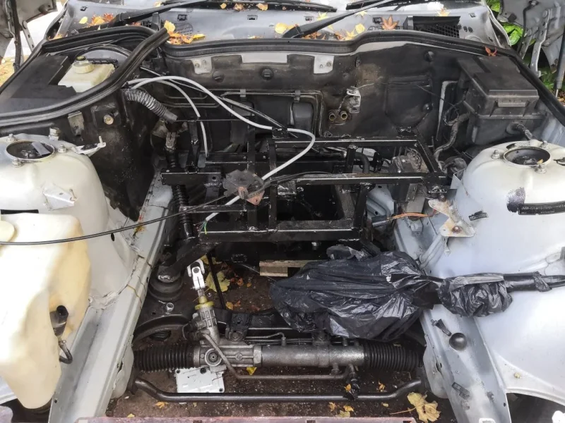

Before I put all the new panels on though, I needed to fit the base plate from the original BMW box. This being aluminium, I couldn't weld it, so instead I welded in four standoffs to the base of the box and drilled them to accept rivets. Having trimmed and neatened the base plate up with the grinder, I dropped it in, drilled through, and test-riveted it. It worked beautifully.

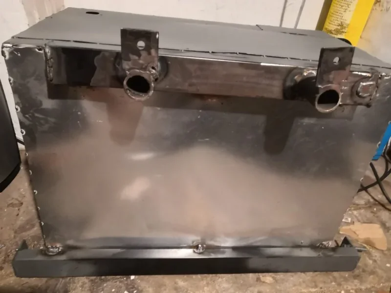

So, the flat panels were welded on, and the whole lot was given a coat of zinc primer. Next up: mounting it in the car.
This was a little complicated. The box had to sit above the steering rack and protrude out almost to the radiator where there was nothing obvious on which to mount it. At the back, I concocted an arrangement of 40x20mm box section welded to two circular standoffs that straddle the steering rack bolts into the front cross member. Two pieces of plate then extend towards the back of the car from these standoffs with holes to line up with unused 8mm holes in the cross member. This took a lot of measuring and tacking in-situ before it could all be welded up and ultimately, welded to the bottom of the battery box.
At the front I decided to re-use the radiator mounts, since these will no longer be used. They're inn pretty good shape and tie directly to the front frame so should be strong enough, though I can always reinforce them if needed. Another piece of 40x20mm box spans the gap between them with little lips sticking up, drilled with two more 8mm holes that pass through the radiator mounts. Again, with it all in situ I tacked it to the bottom of the battery box then removed it for some proper welds.
Given the way this has been constructed, it's far from water tight, so I've bought some brush-on seam sealer to go over all the welds, joints and gaps. Once this is applied, I'll be adding a layer of EVA foam (OK, yoga mat) insulation all the way around before refitting the base plate.
This leaves two final jobs: the high voltage connector and the lid.

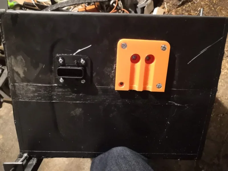

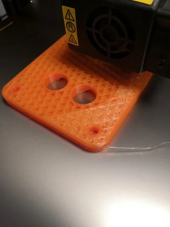

I prototyped a design for the HV connector on my 3D printer which showed up all the flaws: I'd over-sized the spaces for captive nuts and undersized the holes for the connectors. But version two is well on its way. In fact it is two thirds printed but my printer decided to throw one of its periodic tantrums half way through the third component and I haven't had time to sort it yet. I may also need some more PETG. Once I have tested the design I will share it like all the others.
For the lid, I plan to reuse the lid of the original battery box, cut down to fit. This will need a little modification on the underside to create a good seal (probably bonding on some flat strips of aluminium and using more EVA foam). But it looks great. It's all marked up and just needs cutting now. I plan to rivet an aluminium panel to the front of the box with holes that match up to those on the lid so that it can be bolted down.

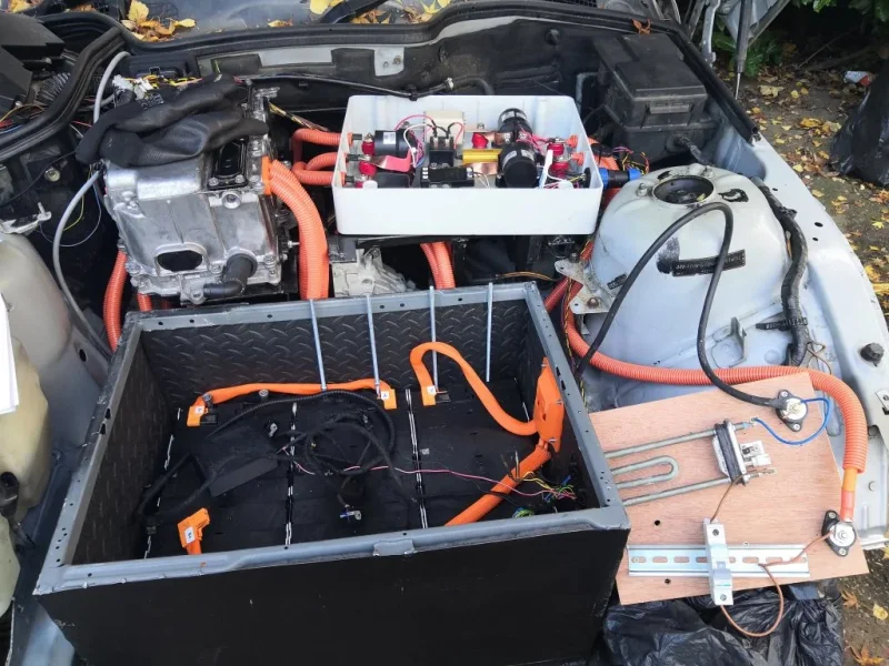

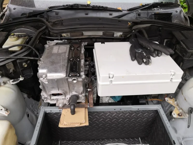

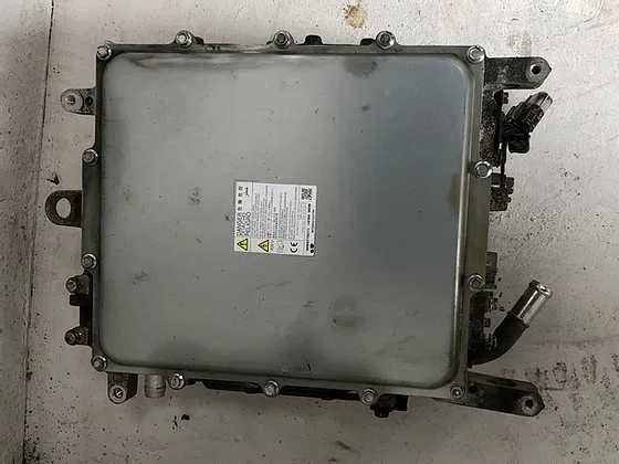

Inverter Mount
About five times over the last three weeks I have dug out the inverter, balanced it in various positions in the engine bay, muttered swearily, and put it away again. On the sixth attempt, I had not exactly an epiphany but at least an idea of how it could be mounted.
I found some fairly thick (maybe 2.5mm? I should probably check) bar in the cellar and decided I could make a U-shaped cradle from that to pick up the Prius inverter's three mounting points. I mocked this up in cardboard before cutting some strips to length with the handsaw - limited time now means earlier starts on the weekend when using the grinder might see my neighbours turn violent. Fortunately the welder is relatively quiet so I tacked the pieces together before checking the fit, then welded it up properly along with some captive nuts. It's not as stiff as the 20x20 box that the HV junction box frame is made from. But once it is welded in it will be stiff enough. A diagonal of 40x20 at the back and two 20x20 uprights will tie it into the rest of the mounting frame.
Cooling
This just leaves the cooling for the inverter and motor. With the battery box in place, I can now see that there should actually be space in front of it for both radiator and oil cooler. This will mean longer pipes than I planned but it will make mounting nice and easy as I can just tie into the slam panel. Plenty of room to route the pipes around the side of the battery box.
Now I just need some time and some decent weather - ideally decent weather precisely when I have some time!

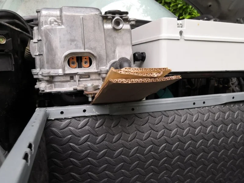

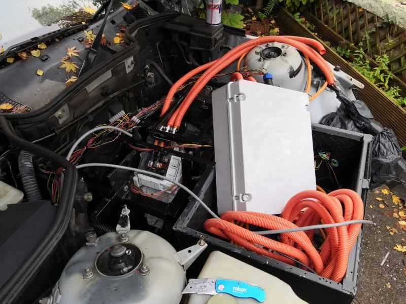

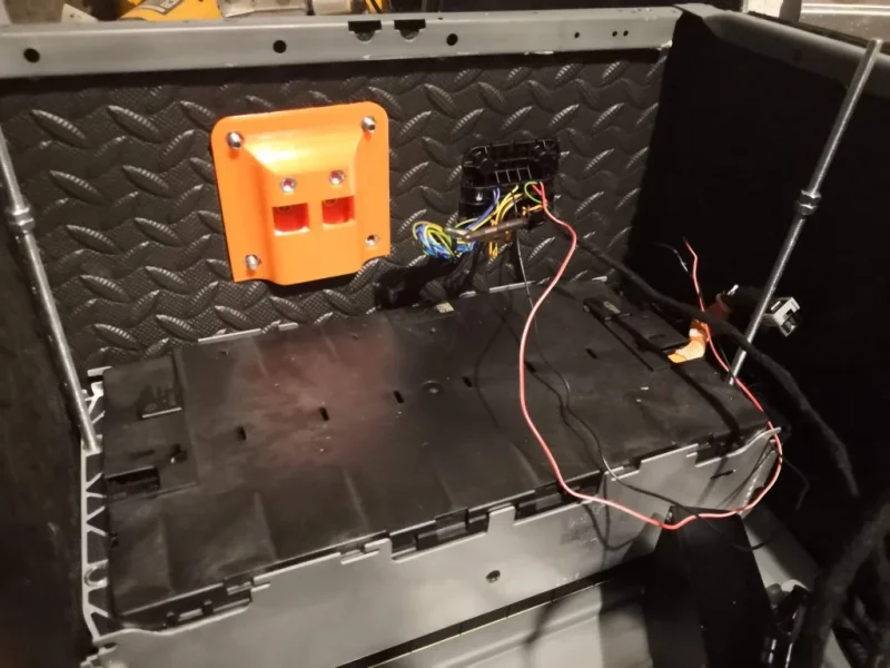

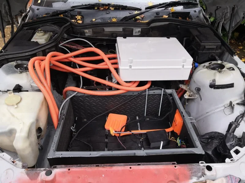

Little update after a bit of work the last couple of days: battery box, inverter and high voltage junction box all now in and ready for some wiring - both high voltage and control. Got some of the 3D printed connectors/adaptors I've knocked up in as well.
Photos show me mocking up the location of the inverter with cardboard and wooden wedges so I could measure out the new steel for the 'cage' that combines the motor mounts and frame for this and the HVJB. Measured up, pulled it all back out (again), and welded it up. Then slapped on a coat of Hammerite. Eventually I want to take this all off and remake it a bit better, or at the very least repaint it properly.

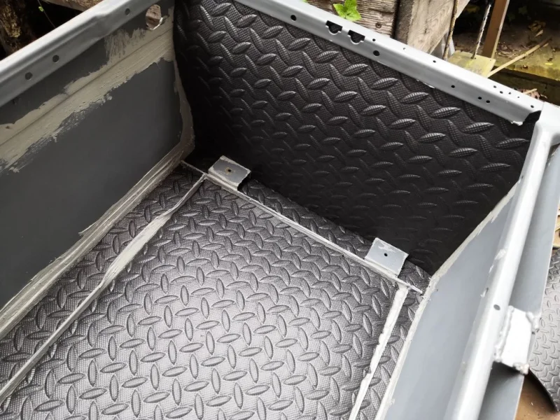

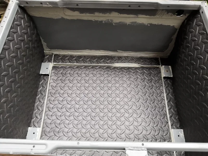

Other pics include the lining of the battery box (cut from EVA foam (yoga mat) and glued in), some connector close-ups, and it all now in situ.
- The orange high voltage connector has a cover that slides over it and screw-in locks that also hold the sheath for the 35mm2 cables. I'll post some photos of that soon.
- The black connector is a combination of a salvaged plug and socket and a 3D printed front plate. The plug that came with it lacked any sort of cowl or sheath so I've also designed and 3D-printed one. I'll post some photos of this as I go through the wiring too.
Issues: I had to push the inverter so far back to clear the battery box that there isn't much space for the AMPSeal connection that carries all the control/communication wires or for the water cooling inlet/outlet (TBC). Think I can clear some space for the cooling with some slight bends in the brake pipes that run across there.
AMPSeal is trickier but have a plan: the riboon cable I have in there that connects the control board to the AMPSeal is far too long. So will swing the connector through 180 degrees and mount it under the inverter where there is now loads of space. OR come up with something completely different.
Next step: running CANBus, 12V and HV cables. Then I'll think about cooling again - got some ideas...

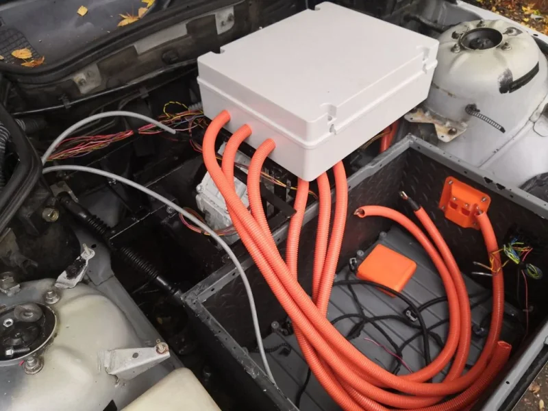

This week I have mostly been focused on getting the car wired up.
Inverter connection housings
With the battery box and inverter mounts in, the first issue I had to solve was the connections on the inverter, which were now fouled at the back by the firewall and at the side by the wheel well/strut housing. I tackled the low voltage connections first, looking at various ways to re-route the large 36-way AMPSeal connector that comes with the EVBMW kit. Initially I was thinking the connector would have to go underneath the inverter, which would have been a total ballache. Then one day I left the loom I was making up sat on top of the inverter and realised there was just about enough space there.
I took my original design for the AMPSeal housing and flipped it through 180 degrees so that the connector came out on top and pointed towards the front of the car rather than the back. Then I added a shell to the back to leave space for the IDC cable that comes from the inverter and the connectors. Amazingly I nailed most of this first time, after some major 3D printing issues. However I didn't leave quite enough space for the solder tabs on the back, meaning I lad to print an extra shim to give enough space. I'll revise the design down to two parts at some point but have posted my current version here.
This all fits beautifully, as you can see. Very happy with this layout as it gives nice easy access to the connector.

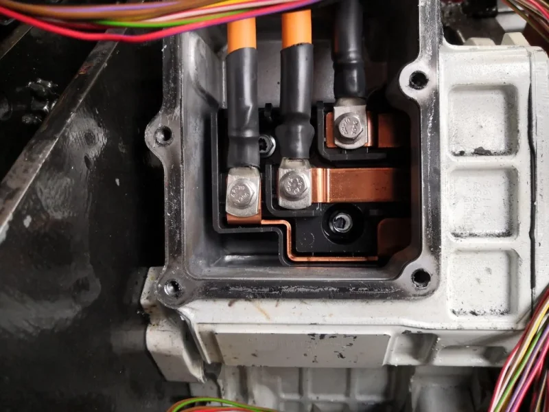

What I haven't done yet is sort out the high voltage connections on the side. These already needed work as I now need three connections: one for ground, one for driving the motor, and one for charging/the DC-DC converter. I think I explained this in a previous post, but basically I have an extra contactor in my high voltage junction box that allows me to engage or disengage drive so that when the inverter is acting as a charger, juice can get to the batteries but not the motor.
In addition to adding the third terminal, I also need to shorten the whole assembly by a centimetre or two so that it doesn't foul the side of the engine bay. Shouldn't be too hard I don't think, though worst case I may need to have the brass standoffs I got from EVBMW turned down slightly. I certainly need a third one making up.
Since I wrote the above I have now redesigned the high voltage connector, knocking about 20mm off the depth, which should be enough to clear the side of the engine bay. I've also added the third terminal for charging. I've ordered some shorter brass standoffs without the flange on that the EVBMW kit has. Beautiful as those are, and useful as the flange is in holding my 3D-printed shroud in place, space is really at a premium for me. The 16mm diameter standoffs I have ordered will still give 100% contact to the crimp terminals at the end of the high voltage cables. And I plan to silicone in the shroud so it doesn't move.

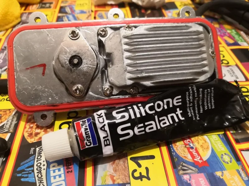

My plan is to keep the heating circuit separate. No point introducing heat into the inverter coolant loop which shouldn't produce much useful heat for the cabin and (I hope) will run quite cool. I have modified an off-the-shelf A/C heater unit to remove the pump so it should run at 300V DC OK. Then I just need to add an external 12V pump hooked up to the switch that normally opens the solenoid valve to route water to the cabin. That's the hope anyway!

High Voltage
35mm2 cable is pretty awkward to work with. Working my way around the car, I worked out the lengths I needed for each of the connections - battery box to junction box, junction box to inverter, inverter to motor - and cut lengths off before crimping on connectors using a borrowed hydraulic crimper (thank you fellow forum-member Alfred/@Maker_Of_Things). I then added a layer of adhesive heat shrink over the crimped parts (also thank you Alfred!)
With the cables made up, I cut matching lengths of bright orange shroud to go over them and began wiring it all in. Because this stuff is pretty stiff, getting it to stay in the right locations while you get a bolt in or a nut on can be tricky - especially in a cramped engine bay. So as you will see from the photos, I actually unbolted some stuff for connections before bolting it back in.
I'm still experimenting with my 3D-printed connectors and shrouds and I'm not very happy with them yet. The pared down connector for the side of the inverter that was tight against the engine bay wall works well enough. And I'm happy with my shroud for the motor connections. But neither of them hold the shroud as I designed them to do. Bit more work required to tweak those before I share them.
The worst connector was for the battery box. This was incredibly fiddly and I don't think it shields the two connections from each other enough. Back to the drawing board on that one.

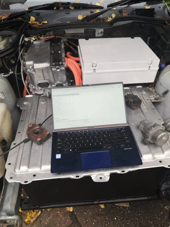

So, after the little success of last time, I was very keen to get the wheels spinning. And if I'm honest, I wasn't cautious enough. And that's being polite about it. I was a bit of a knob. Twice.
With one battery pack hooked up, giving us 60V, we put the key in and gave it a twist. The inverter came up, but when we turned the key all the way to the start position, the inverter didn't start.
Not sure what happened on my previous test but it turns out I had my 'start', 'brake', and 'cruise' wires mixed up. I switched these around and sure enough, turning the ignition to 'start' actually flicked the inverter over into run mode.
I pressed the throttle and we got....vibration. The wheels didn't spin. This is where the first part of my incaution/idiocy comes in. I dumped the throttle to see if it just needed more juice. It rattled a few more times, then stopped. Bear in mind at this time, I had nothing inline to limit current. Because I'm an idiot.
The next day, doubling down on my idiocy, I figured it just needed more juice. So I hooked up a second pack and put the inverter into manual mode. I don't know what I was thinking but half-remembering the FOC setup process, and having not watched the guide video, I put some small numbers in for manual current and then increased them until they were not so small...
No movement. Also DC current showing zero. Hmmm. Now I start to worry.
Next day again (work is busy and there's not a lot of daylight). I go out to do some more testing, this time having watched the setup video. I got back to basics: swap the Field Oriented Control firmware for the Sine firmware, and start the setup process from scratch. This time with a heater element (I don't have any incandescent bulbs) in line for limiting current, as well as a 20A breaker (horse, stable door, bolted). There is a slight burning smell and I realise the magic smoke is coming out of the little buck converter powering my VCU.
I disconnect this and continue with the testing and everything seems to be working fine with the inverter. It's starting and running as it should, and measuring the voltage accurately from the batteries. I'm seeing some DC current. Still no movement but there could be lots of reasons for that.
Then the weird thing happens. I turn the inverter off and go do something., When I turn it back on, it is reading 818.37 volts on the DC bus. This figure is rock solid and unchanging. Rebooting the inverter, clearing parameters, even updating the firmware: nothing changes it.

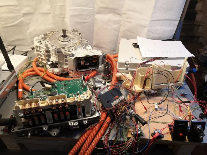

So, feeling like I have potentially burned my motor, and with my inverter being weird, I decide to pull everything out and rebuild it all on the bench for testing. This felt like a big job looking at it, but I actually had it all out and in the workshop within an hour, and reconnected with an updated version of my test rig (including key switch etc to replicate the cabin) in another hour and a half or so.
Then, with help via Skype from Jamie (@bigpie) I got to work trying to understand what was wrong with the inverter first. Going around the test points from the original build with a multimeter, it was clear something was wrong. Even with everything disconnected, my 5V lines were down at 4V and my -5V lines at -2.9.
Jamie suggested that maybe a MOSFET has blown closed and that is the next thing to test.
Next steps
In some ways I am quite glad to have the setup back on the bench. It has been hard to do much on the car with the dark coming in so early. And with the charger (yet to be unwrapped), port and cable having now arrived, I can also look at getting those working. While everything is out of the car I can use some of the daylight to finish up the hardware jobs I hadn't done yet: finally fitting the power steering pump and lines, and adding mounts for the cooling systems.

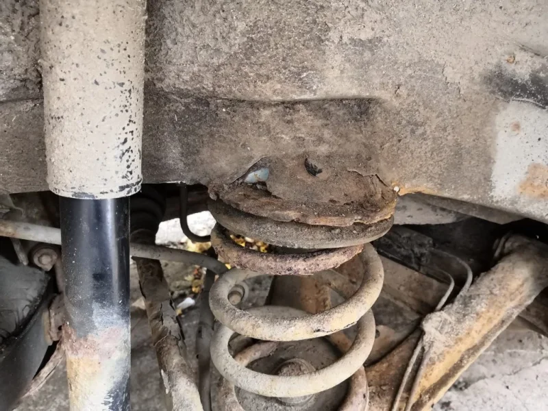

Question for you Z experts. Have searched the forum but can't find an answer: How have people fixed rusty rear spring tops? Took the back wheel arch liner off so that I could remove the remains of one of the rusty outer sills, and to make it easier to drop the rear subframe in order to remove the fuel tank. Realised once I cleaned all the mud off the top of the rear spring top that it has completely rusted through.
I can't replicate the curve it had before but I can weld in some plates on the diagonal to reinforce it. Do you think that will be OK for MOT/safety?
That should suffice Tom, just ensure you use steel at least as thick as the original and seam weld all joints.
Thanks Tony. Glad to hear my instincts were correct! Have some new steel in and have bought a brake to get some nicer bends. First experiments have come out fairly well with new brackets for the power steering pump.

Outlander inverter
There are some things to do inside though. I've been working on getting the Outlander inverter working. (I'm updating the components page with information as I understand it). This unit looks to have been in a small engine bay fire. The low voltage connectors are a little bit...melty. But they still have all their pins and I successfully have the inverter turning on and spitting out CAN messages. I just don't understand them all yet. And early experiments to make it spin the wheels have been unsuccessful. I suspect some of the messages it is spitting out that I don't understand are errors.
outlander_inverter_1.webpoutlander_inverter_2.webpoutlander_inverter_connectors.webpoutlander_phev_inverter_testing.webp
SavvyCan
To help me with CAN diagnoses, I have bought an Arduino Due that I'm setting up for SavvyCan. But this is proving to be more challenging than expected. I can't get the sketch to run properly - it won't spit out anything to the serial terminal. So that needs some work as well. [update: this is now sorted]
BMS
Once I have that working, I plan to use it to get the BMS working properly. I had this set up wrong initially, with one CAN interface connecting to both the battery units and the rest of the car. Instead you should have two: one for the battery modules, and one for the rest of the vehicle.
With that in place, I want to get the charger running. There are some quirks to this as I need to have the BMS turn it on and off once the batteries hit target voltage. Hence focusing on the BMS first.

One thing I have done is some work on the salvaged Safety Box from the BMWE battery pack. Turns out this is a complete and very compact high voltage junction box. Others have already done the work decoding the CAN messages from it to get detailed voltage and current information. And it proved relatively trivial to rewire control of the pre-charge relay and contactors through the original connector, giving me a nicely compact alternative to my own, very large, junction box. So compact in fact that it will fit inside my battery box.
This solves two problems. First, it means that I don't need to worry about a safety disconnect: if the 12V is off, there is no way for high voltages to reach the battery box connections. Second, it frees up the space where the junction box sat so that the charger can go in its place, meaning I don't need to alter my battery box.
What I do need to do is sort out the design of the high voltage connector for the battery box, which proved not to work very well. That might be a project for this week in between work.

In the meantime, I have stripped down the inverter and removed the broken board. Damien was very reassuring, telling me it probably wasn't me who fried it and has kindly sent me a replacement. So, board number three (!) is off to the soldering whizz this week so that I can get my inverter back up and running.
I think I am probably going to stick with the Prius inverter rather than switch to the Outlander one. That is great for some experimentation but the Prius inverter gives me lots of flexibility and things like direct control of the contactors. If I switch away from that I will have to make up some new hardware for the BMS to control the contactors and that just feels unnecessary.

Still lots of work to do on the car itself, including welding up the rusty rear spring mount. Some new steel has arrived from Frost restorations for that, and I have also invested in a brake for folding brackets. These will be used for the repair patches for the spring mount but also for brackets for the power steering pump (which I have decided to relocate, based on advice from my daughter - she suggested the new location weeks ago and I have finally listened) and the heater, which I might as well get wired up while I'm at it.

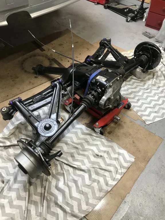

I can offer some advice on getting the rear subframe out however. If you can’t undo the prop to diff bolts then undo the central prop connection (a large pair of grips will work fine) and the support bracket and when you remove the beam carrier assembly the prop will slide apart.
Fantastic - I did wonder if there was another way to do it. That should make life much easier. Thanks!

Regarding that weld repair, zap it with a wire brush in a grinder, then clean the metal with a flap disc. That'll show you how far back you may have to cut.
If it just stays as that crack, and you have any copper sheet/plate/heat sink, you can place that behind the crack and stitch weld it closed. Don't try and weld all in one go, pulse it, one second weld, one second off, move so as to overlap the previous weld. Essentially it's a series of overlapping spot welds..
If you do have to piece a bit in, the same technique puts less distortion into thin metal.
From your other weld pictures, as I think you've already surmised, something wasn't right.
I think you've already checked your earth, but it's worth opening the machine and shortening the cable to where it enters the machine, tends to fray internally there. If it's a dinse connector I'd shorten it about 6-10cm, that's where all the fraying occurs.
