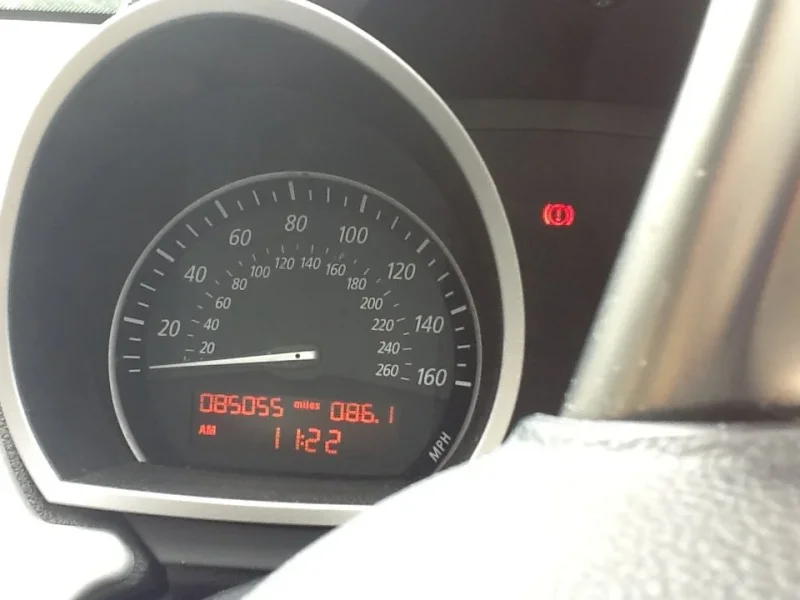

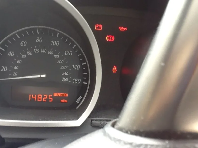

Seeking some advice on what could be causing the OBC to not show any information when depressing the stalk. The display seems to be working fine as the clock, service indication all seem Fine and when I first drove it did display the range of miles but Wouldn't switch to show other features. I did change the battery but since then even the range indication no longer shows..I have had the binnacle out but nothing obvious and ideally want to avoid having to send that away if possible

Hi Colin have tried neither of those tactics so will give them a go and let you know, thanks for your prompt response
Update: Have checked the fuses physically and with meter and all working, also reset1 had no effect eithe
