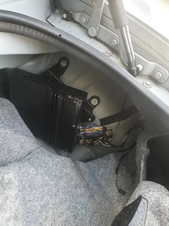

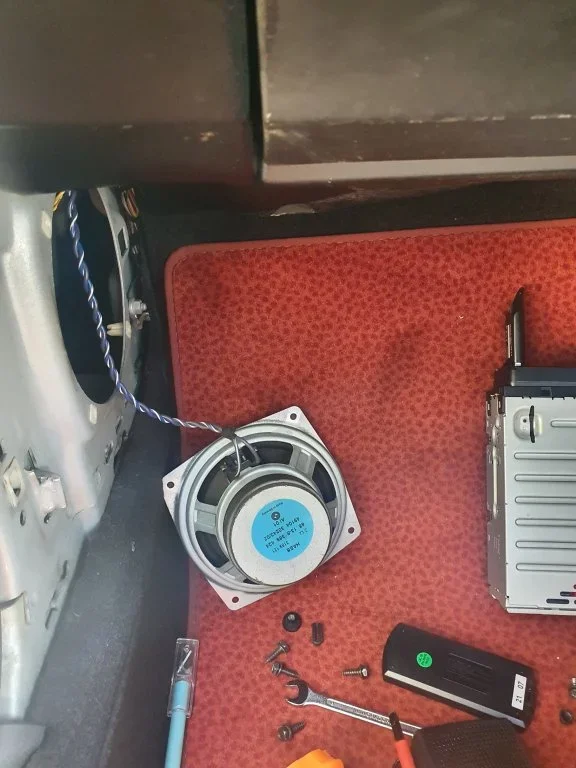

Hi
i would like to ask which color from the front will power the amp in the trunk of the car (bmw z3 2000)
thanks

Hi
thanks
I have no clue TBH, I am guessing here you have a failed amp ?...
i am changing the radio with aftermarket, what i can understand is the amp don't have power i am not sure which wire can be used from the front. Thanks for your respond
Unless I could get my hands on a wiring schematic I would just find them by continuity testing, using the assumption that the culprits should be a heavier gauge than the others. Someone else here may have a better clue...
