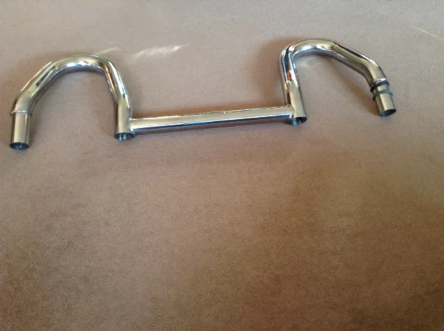

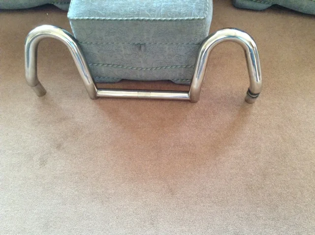

Do you have a picture of your new bar please?
Hi Gents
Thanks for your reply, I have attached some shots of the bar, hope it helps.
Am I right in my thinking to un screw the 3 torx screws after removing the caps and slid cover up over seat belt ? to reveal the bar fixing ?

Hi Geoff, yes the socket is revealed when the cover is removed. I seem to remember that you may have to remove the cubby box to get at the inner torx screws, but I could be wrong. If the car had genuine BMW bars fitted originally, the covers have a removable panel to access the bar mounting screws. Non rollbar cars have no access cover, if yours are this type the holes may have been cut by a previous owner to fit a smaller diameter bar and that is why your new ones won't fit. The mounting points have quite a bit of slack so once you have enlarged the holes in the plastics your bars should fit. Hope this helps.

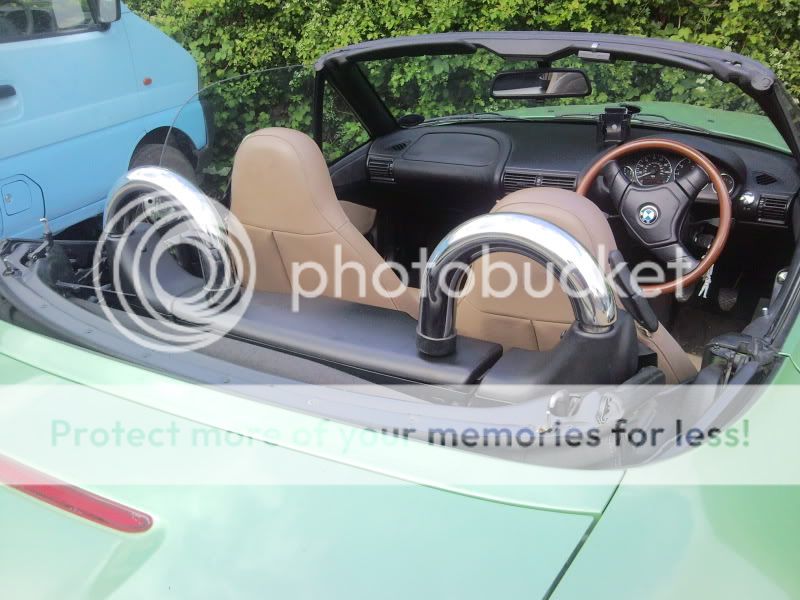

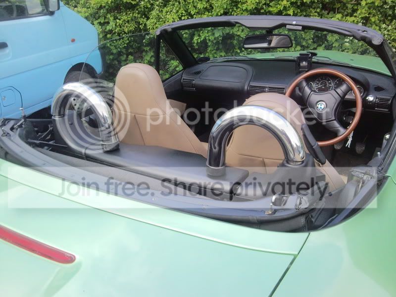

Some pics of your turret plastics would be helpful. I suspect that you will need the ones with the access cover to be able to fit the rollbar. I will take some pics of mine tomorrow.​
Mine looks like this.
Hope this is of some help.
Hi Tony
Yes thanks, mine looks like your bar, BUT how do you get it all back fixed in place as some of the screws are inside the cubby box and the bar that joins the two hoops goes across the top or is the top box cove just held in place after fitting bar with only one screw ?.All the bits of help in the forum do not seem to cover a step by step ionstlation that I understand.

Hi Tony
How did you fit yours.?
