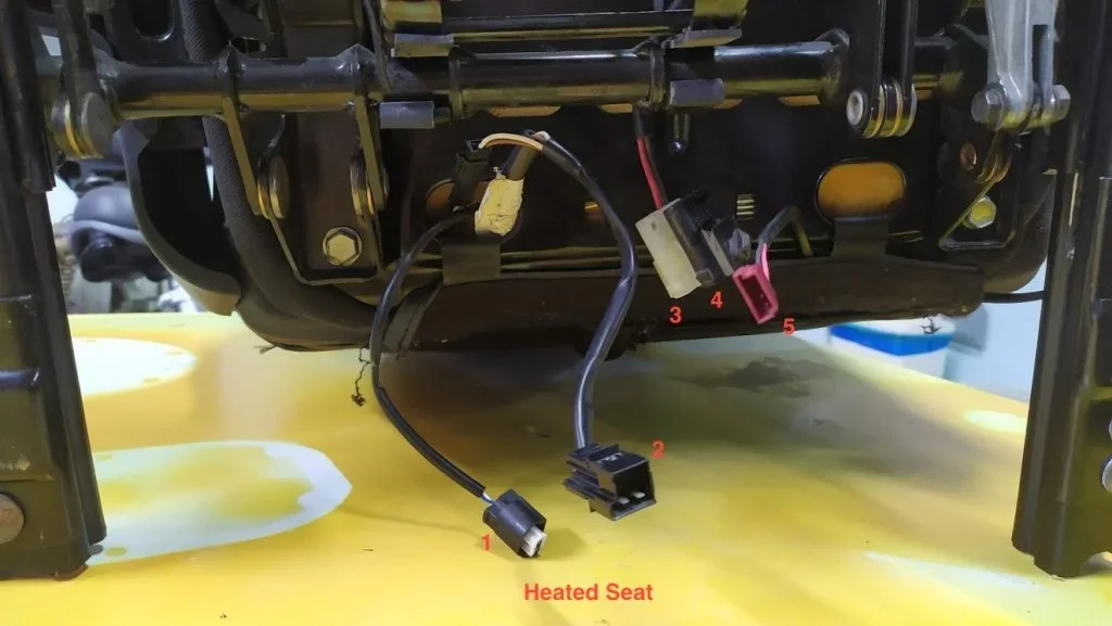

Hello everyone.
I have a big long query with regards to my (newly bought) heated seats. I have read most of the threads and some other but still have some difficulties.
Please note that all picture are from passenger side.
I would please like to ask the following:
Q1 - I did read that all facelift models "should" have pre-fitted cables installed for heated seats.
note q1.1 - I did lift the carpet and flooring and apart from the main cabling braid (see picture below) I did not see any further cables.
note q1.2 - Looking at the fuse box there is no "dedicated" fuse for heated seats though I do see for heated mirrors - not sure whether this plays any role.

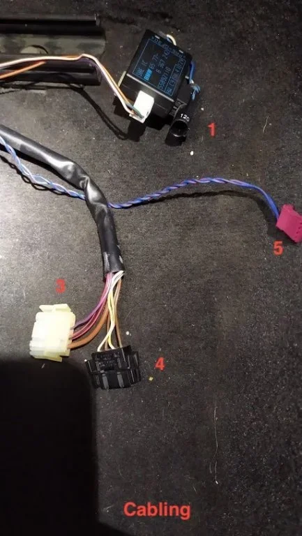

Q2 - Can somebody help with the cabling below. There are two pictures attached: Pic1-Heated_seat.jpg & Pic2-Cabling.jpg
I have numbered the cables that I know (or at least think I know what they are).
Numbers go together (male-female inputs)
Cable 1 : Passenger sensor for airbag (identified from part number)
Cable 2 : This should be the heated element. Looking online there are several types - One found had the exact same cabling as this one. No cable to connect to.
Cable 3 : Electric seats (up/down - backward/forward)
Cable 4 : Comes underfloor and ends up on the air - the female part under the seat is cable less - no cables on this (WHAT IS THIS FOR?)
Cable 5 : I suppose this is again for passenger sensor (not sure though)
Any help would be greatly appreciated.
In principle the question is (given that I have the cabling right): What the vehicle cable 4 (that ends up nowhere) and what can I connect to cable 2 under the heated seat?
Thanks and all the best everyone.
