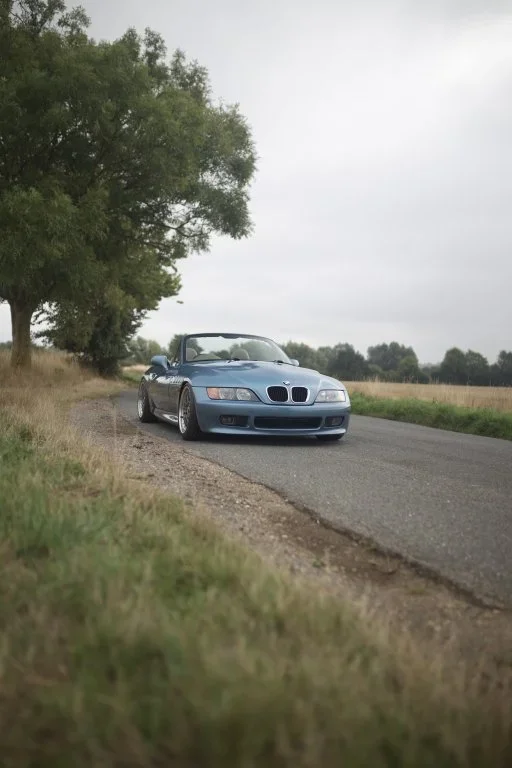

New to Z3 ownership just wondered about a couple questions for the UK owners is heated seat wiring and cruise control wiring already in place even if my car doesn’t come with them from factory. My car is a 1.9L 1997 if that makes a difference. Also if anyone knows what you need to retrofit cruise control please let me know as I haven’t got a clue
