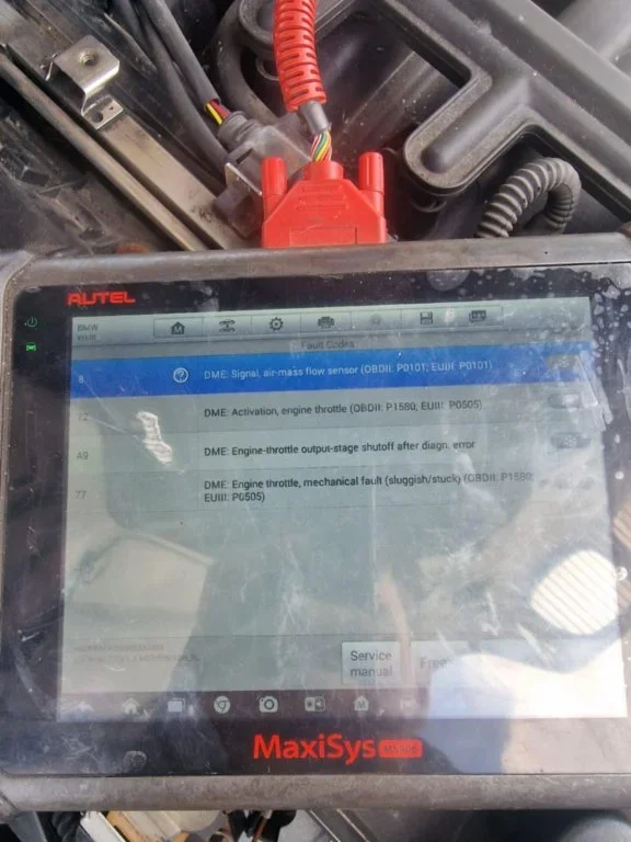

Also changed the throttle body but hat appears not to have fixed anything.
This is a screenshot of the OBD codes.
Update
After a lot of frustration with the mechanics… I met a man who can.. with electronics. 2 burnt out capacitors (or something) & some new tracking on a circuit board and she revs! No Engine Management lights at all!!!
