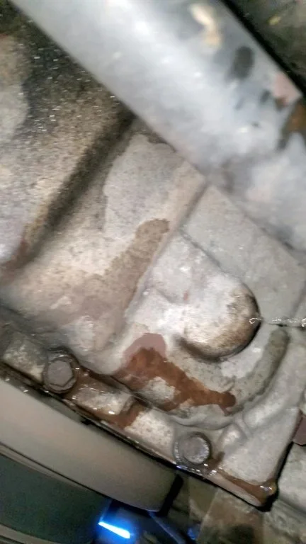

Thanks guys, I got up under the car and see that I'm leaking coolant from the main crank pulley. I know its not coming from there, but I do think its the waterpump that's just above it that's causing me to lose coolant. Is there any other explanation to what could be leaking aside from the water pump? Photo attached is the crank pulley and water coming off of it.

Water pumps are bad if they are leaking water or they produce bearing noise/squealing in extreme cases.
Most overheating issues are due to low coolant levels, the thermostat sticking, and clogged radiators.

Hey guys, some more info. The leak is coming from the water pump. I had the car running and saw the water pump pulley moving back and forth. It has play when the car is off also, as if the pulley is not fastened down. I believe the water pump pulley/mechanical fan pulley play has caused the water pump to fail and begin leaking so i will be replacing it as soon as the new pump/pulley/fan comes in the mail. Im hoping the timing cover is not also leaking but my oil looks fine, not milky.
