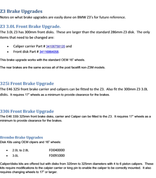

Hi
The attached file are my notes from posts from all around the interweb about Z3 brake upgrades.
As with all upgrades, please check your local laws and automotive rules to see what is allowed and what has to be certified.
Hope it helps.
Regards
Muzz
Here it is as a picture, Hope that works better.
