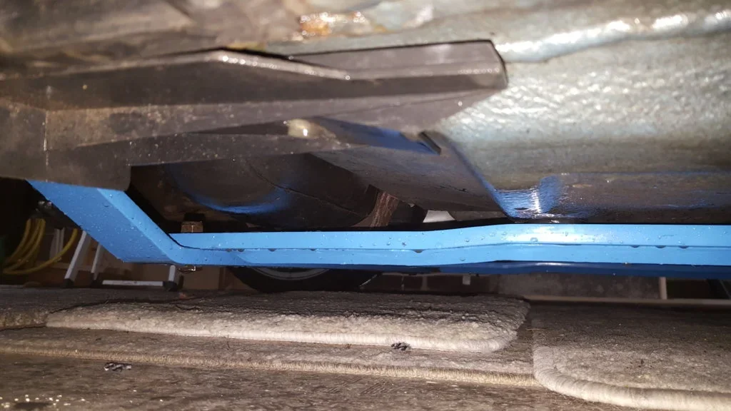

My car was low to start with but when the butt strut and body brace where on although it handled supurb and felt very tight the clearance i had worried me slightly so i removed it.
If it struck some thing it could have been nasty.
My car is on Apex springs so as low as any spring kit goes bar coilovers and this was its clearance.
Just under 100mm clearance never caught anything but was always a little concerning although the body brace would take any brunt.

Thanks for the picture @antm62 - says a thousand words!
