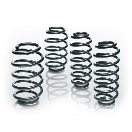

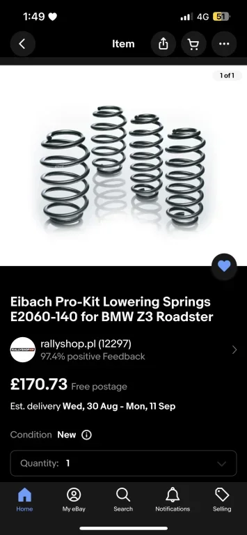

Ive seen these springs on eBay so I may just purchase these for now and not replace the coilovers just yet.
These should give me the same ride heigh I currently have and I suppose there reasonably good springs?

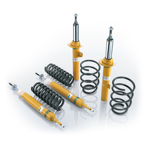

Oh these the bilstein ones you mentioned? @Ianmc
Looks like it, with B8 shocks. Think they lowered slightly less than the 30mm mentioned, but think the stance is just right. Worth the investment if you can stretch to it! :thumbsup:
Any reviews/opinions on these?
I put the B12 kit on my e89, great setup, didn't ruin the ride but improved the handling no end.
Nice one thanks @Nodzed :)
think im just gonna get the springs for now to get her back on the road but these will be a future upgrade for sure.
Another vote for B12 kit. Replaced my tired shocks and springs with it last year and the difference is night and day. Slightly lower as has been said, but just the right amount.
TBH even replacing tired original suspension with new standard stuff the difference would equally be "night and day" so it's a hard to say it's just because it was the B12 kit, even though its known as good gear.
