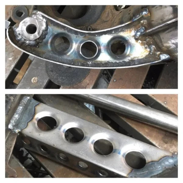

The M uses the narrow arms braced. The arms aren’t ‘narrow’, or ‘wide’, it’s the stub on the end which is shorter, or longer. Easy to brace, there are kits of laser cut steel, or just make your own. Www.garagistic.com or similar, anyone who does E30 stuff, same arms.

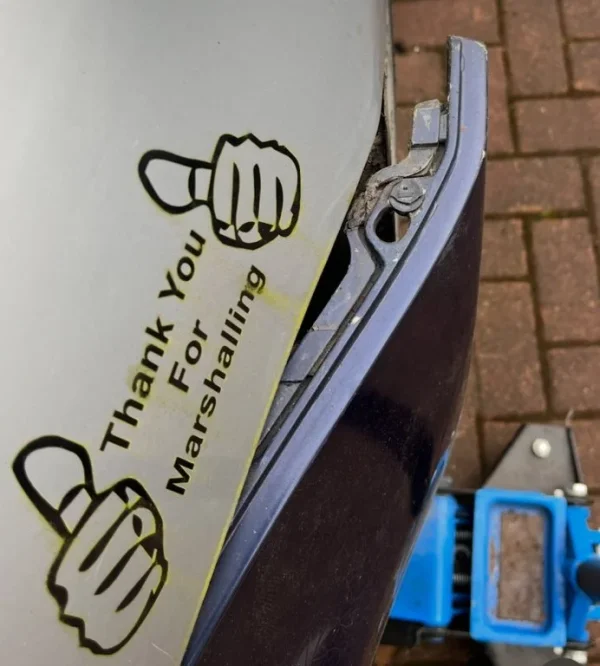

The difference
Narrow wing, Wide bumper.
The internet states only a 25mm/1” difference but on mine it’s almost 35mm at the wing edge.View attachment 346333
Are you replying to me? I know the wings are different - I was asking if the trunk lid is a different shape (apart from the licence plate)?

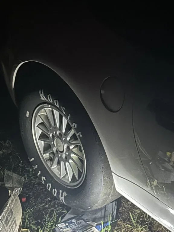

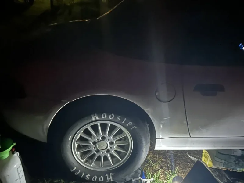

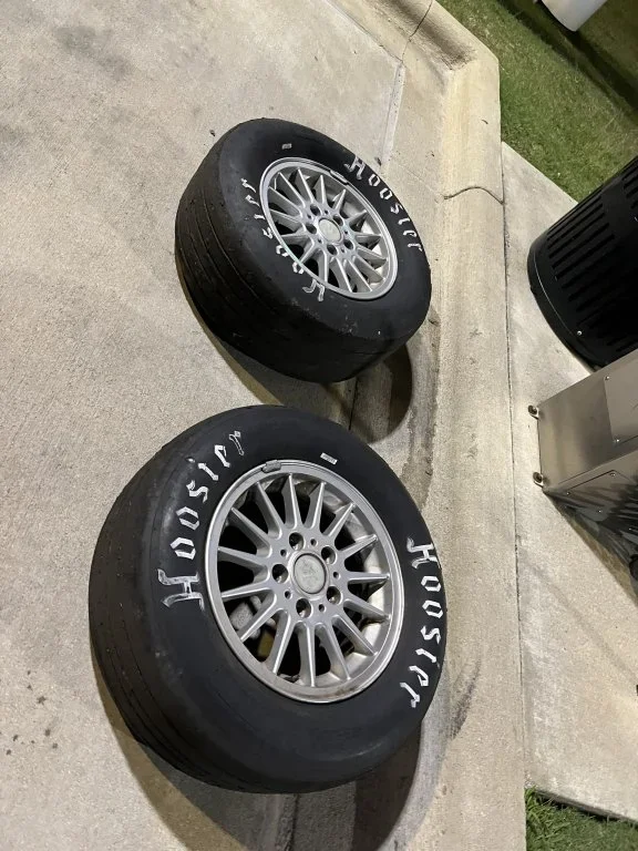

Also I found the most American fitting solution for my traction issues (haven’t put the front set on but I do have matching wheels and a set of tires for the front)
I’ll send more pics in the morning but hoosier drag radials and style 32 wheels clear PERFECT
also picked up my driveshaft but that being said I’ve been up since 3am and need to get some sleep so I’ll get it on the road with that tomorrow
