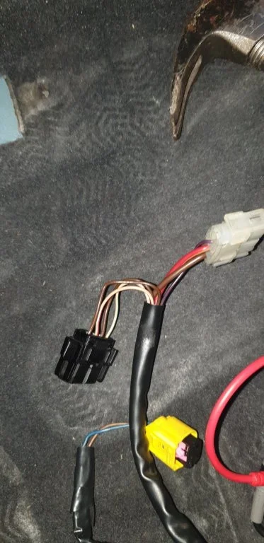

Does anyone know if I use the earth cable, from what I think is the heated seat module on the left, will that potentially solve the grounding issue or are they connected together.
Or simply a new grounded wire to that point.
I'm almost sure its the grounding on the drivers side as some of you have said thankyou!!
I'm getting +/-11.5 v in the passenger seat
and +/- 10.5 v in the drivers seat
Only difference is both seats work on the passenger side and neither work on the drivers side.
I've tried to tell from the electrical wiring diagram but I'm still not 100% sure
Thanks
