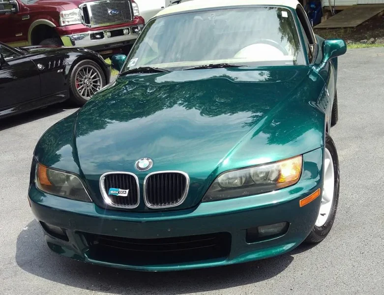

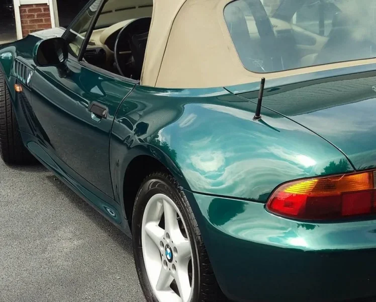

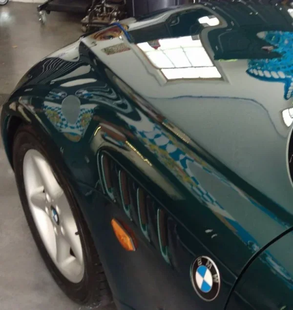

:welcome: to the Forum from West Cumbria, England. Sorry, can't help with the issues, some techies will be along shortly. Cracking pics of your Zed (Zee) :thumbsup:
