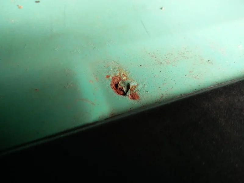

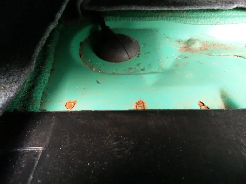

I'm about to change or upgrade (not sure which route now I've read some project threads!) the bushes and suspension on my Zed but I also saw a post with a picture of the boot area in someone's Zed almost rusted away (rear beam mount?). Three of the spot welds on the boot floor of my Zed (a 2.8) are showing signs of rust - a garage had a look and told me to clean it up, add some kurust and paint it over - should I just do that or should I be worried about the rust and it needing some serious work? Cheers.

Not sure you will get anywhere with BMW but worth a try, the issue you have needs to be addressed with some welding, not as bad as you may think so don't worry too much, there was a number of cases like this a while back on the forum and a garage that was good and reasonably priced at the repair, hopefully someone will remember where?
If it were me I would just plug weld on each of the spot welds. By drilling off the top layer you will have a 6-8mm hole to fill with weld and that should be stronger than a "spot" weld. A spot weld is created simply by crushing two pieces of steel together with 2 electrodes and passing an electrical current through the steel till it melts the two layers (fuses them) together in one small spot. Hence the name.
Cheers @t-tony - I'm going to take the subframe off so I'll be able to give it a good clean and make sure that the box profile hasn't got rusty inside (the spot welds are rusty so water has got in somewhere) or at least fill it with rust cure and waxoyl! Thanks for the advice, will save me a bit of money going that route.

ps. If you've got the rear axle subframe out then maybe it would make sense to seam weld round the mounting.

The broken spot welds are an indicator of weld failures that are hard to see on the left where the cross beam meets the main chassis rail. You need to fix that too or you will be back there welding the spot welds many more times if you only do the spot welds now.

Cheers. I'll see what BMW say but I'm not confident in their ability to fix it to be honest - the BMW bodyshop I took it to had never seen the issue and was basically bewildered as to the solution and said that he didn't think they (the bodyshop) would get involved as they are very busy with accident repairs.

@Dickymint the spot welds on my car have all cracked so are not holding on to any metal so need a bit more than rubbing down - I wish it was that easy lol! There's a guy called Martyn Scott down in Kent who has fixed my type of damage many times before - strips and cleans the underside, removes all rust, re-welds the spot welds and then adds a strengthening plate on top so might try him if BMW don't do anything.
