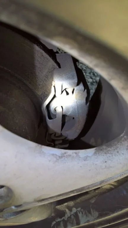

I attached a picture of the back caliper, I'm shining a torch on it which is why it is so bright.

Digging into it a bit more it sounds like I might replace them. There is a discussion here [5] where some people think they should be replaced and some think they shouldn't as there doesn't appear to be anything wrong with them. Either way thought it sounds like the brake fluid should be bled, and if I'm doing that I'll just replace the calipers.

Back in my motorcycling days it was said that if you can still use the back brake you're not using the front ones hard enough.;) Having said which, you need to get the back end up in the air and find out if the brakes are applying properly when you press the pedal and releasing when you let the pedal off again. If they're working OK then no need to change them. Don't know about over there, but here it's a whole lot cheaper to buy a set of seals and refurb the calipers you've already got, at least that way you can be sure you've got the right ones.
New discs may help more than new calipers, but it's hard to tell from here. And these rear brakes are a bit prone to have noises inside from the handbrake bits.
Thanks for your advice. I decided I won't change the calipers then.
I'm just going to measure the thicknesses of the pads and rotors and go from there. Hopefully I can avoid changing anything for now :)
