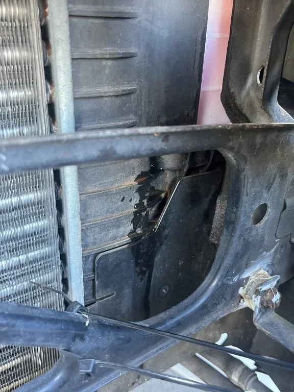

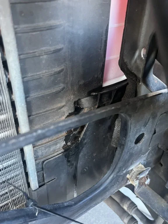

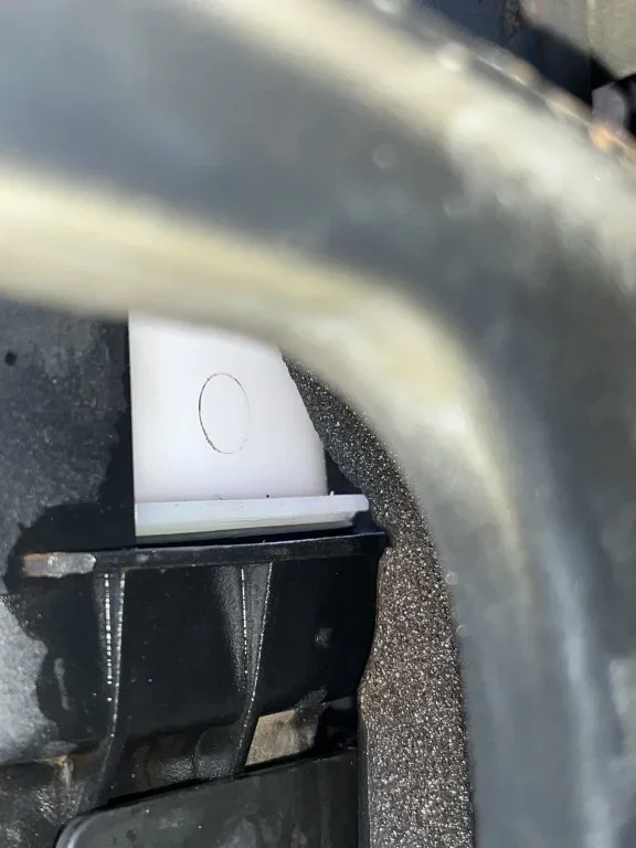

So after some inspection this morning it seems like the leak is still coming from the bottom of the expansion tank.

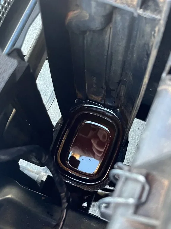

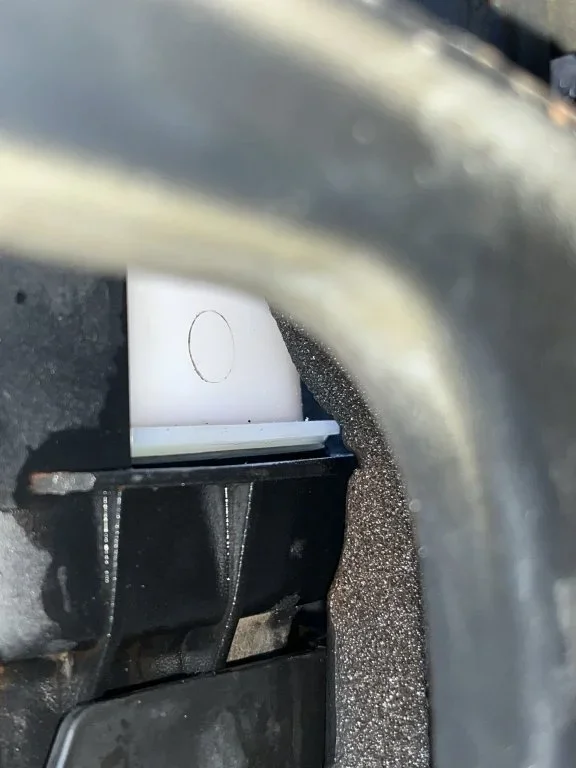

Still potentially leaking from bottom of expansion tank doesn’t look like it’s installing far enough the second o ring is still prominent as pictured.
