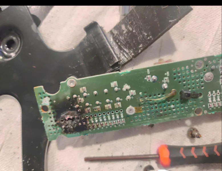

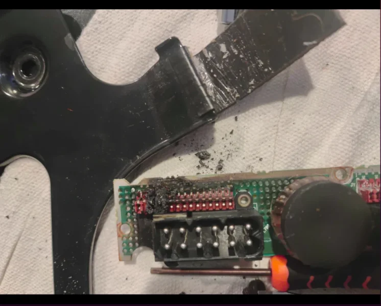

Well I think I found the problem, after smelling smoke coming from behind my cd changer, I found my amplifier was fried. My concern is why this happened in the first place. Any reasons why this could happen? I'm also currently looking for a replacement part, 65128399683 and am having a tough time finding a good one. Any suggestions on where to look (I've already tried Ebay and other online shops).
