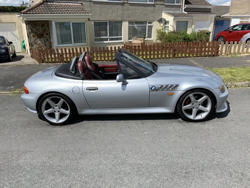

Looking to lower my 1998 1.9
Really need help on what will be best for the car. I want around 40mm ride height. Looking for all round balance between aesthetic and performance.
Looked at lowering springs, coilovers and lowering kits. On a budget of £300
Please can I have some advice on which is the best? Photo attached to give you guys a better idea of how far car needs to come aesthetically.
Thanks :)

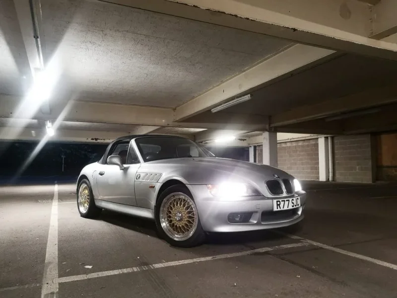

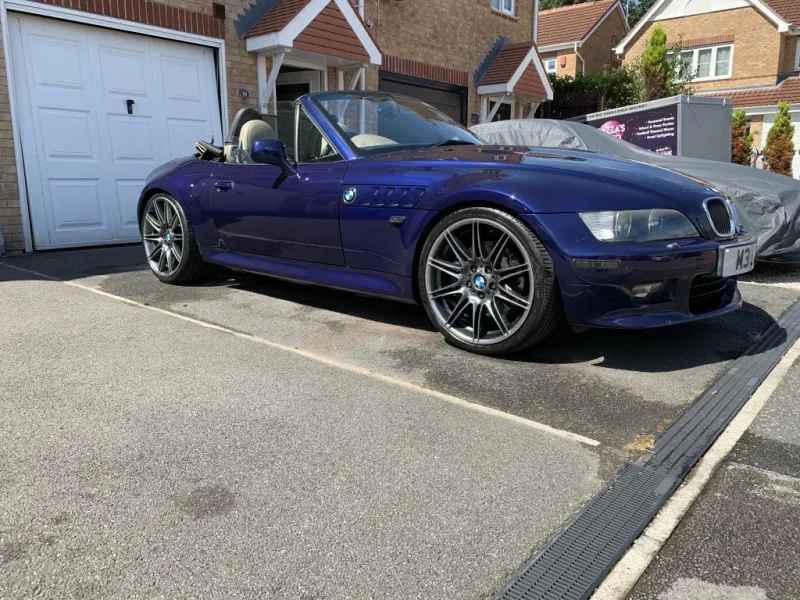

For both my 1.9 and 2.8 I’ve gone for Monroe shocks and Eibach Pro kit springs. Very happy with the drop :thumbsup:
Also something I found out on the way is that the spring pads are different thickness for different engines. So your able to get thinner pads for a bit of extra drop.
My 2.8 with drop
My 1.9 with drop
  • Like
Reactions: Lee
