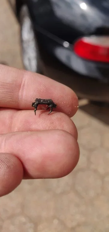

Step 1 - Take photo of old window and convince myself this was do-able….I then took the passenger seat out and this was a master stroke. We definitely needed the space to do the stitching and provide some working room.

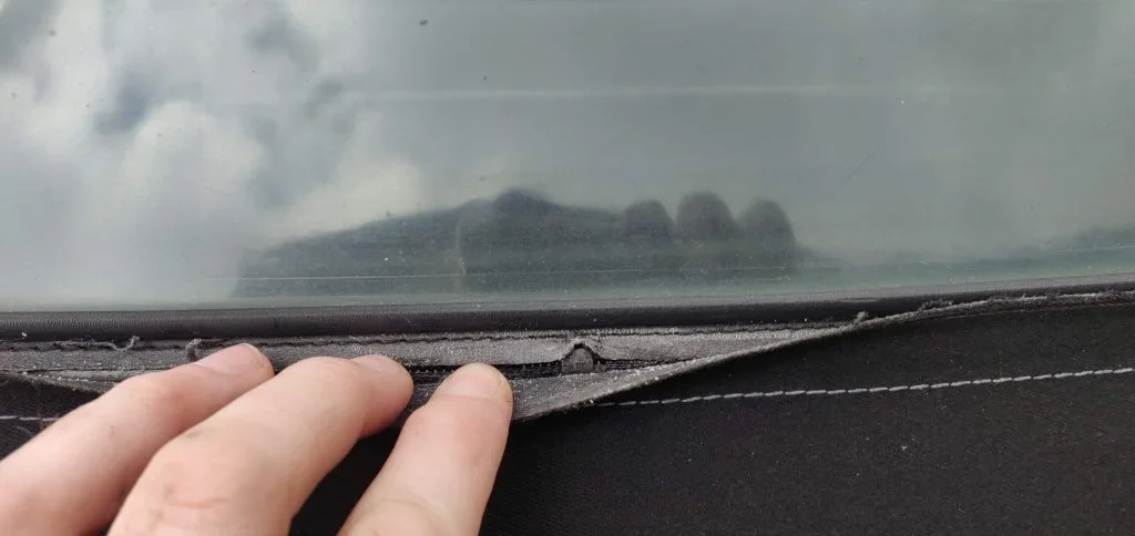

Using the supplied tools, I then stripped the roof material from inside the black bead all the way around and went searching for the zip retaining clasp which was easily found.

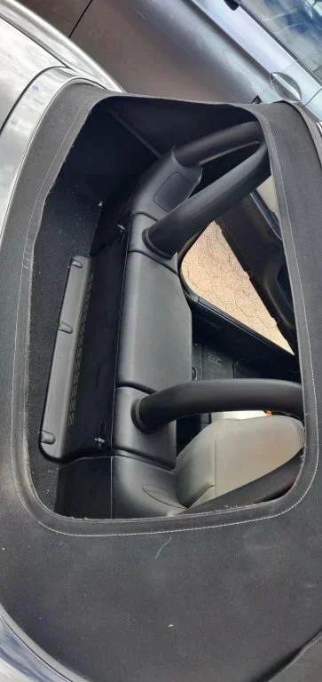

From here, breaking the zip seal was straight forwards with the screwdriver and out popped the old window. Definitely in it now!

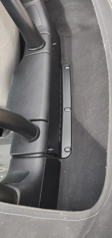

I took the opportunity to vacuum out the area behind the seats as the last time this was done was probably 20 years ago! Also a good time to clean down the plastics as they were covered in dust.

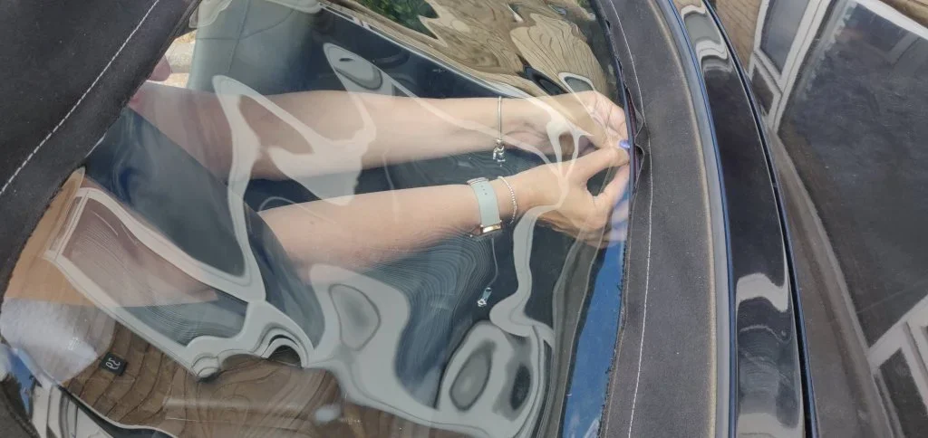

From here, we lined up the zips and zipped it in. We had a few false starts where we connected the zips and it was too tight, but on the third attempt we got it just right. Another tip would be to lay the screen on the boot on a towel and offer the internal zip upto the new window. This makes alignment really easy and from here it simply zipped in. We maybe over analysed how to do this, so in the end we lined up the tabs on the zip and in she popped.

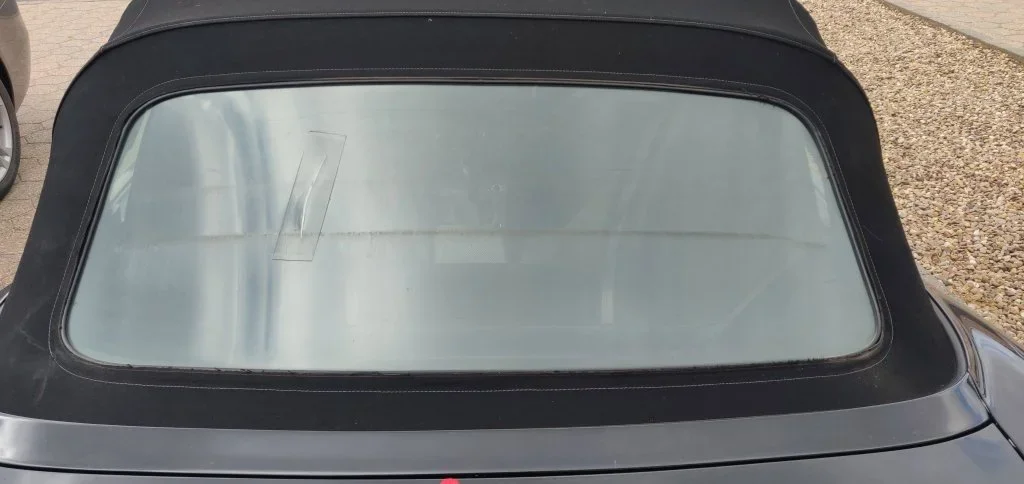

Once zipped in, we put a few stitches across the zip to stop it opening again and tried the roof and it worked! The zip stayed “zipped,” and I tried it a few times to make sure.
I then went around fettling the material under the outer bead of the window and that was it. Whole job took about 1hr 45mins, and the result looks brill!
