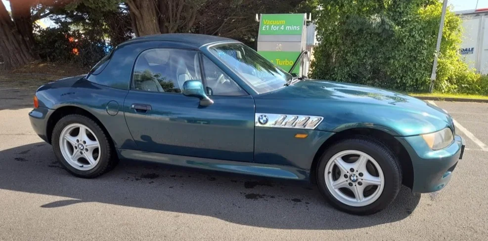

But apart from that the most important thing I found when fitting mine is to have the vertical line behind the side window perfectly in line with the front edge of the rear wing. See my profile picture.
