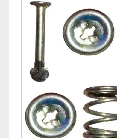

Have you fitted spring retainer cups to hold the spring against the shoe, as Colb mentions above?
These type of things
From what i found online Z3s didnt come with those washers but you can get them if the shield is rusted like mine.
Seems like a proper solution.
But will my temporary fix work? Even for a few months?
I wouldn't want the spring on the rear side of the dust shield to get all rusty and end up letting go. Find some long slender bolts and nylock nuts to use with the retaining cups on the spring. Head of bolt at the rear of the dust shield spring and retaining cup inside and on the outer side of the brake shoe, secured with the nylock nut.
If you're going to bodge it, bodge it properly.;)=))
