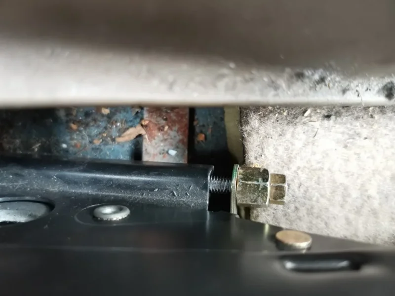

Hi, I recently joined the site and mentioned in my introduction post that I was going to refurbish a brake caliper. After removing the wheel and also looking at the handle inside the car, I think the handbrake is stuck on the driver side rear wheel.

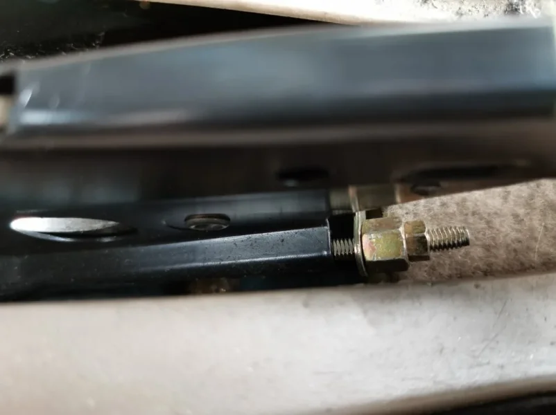

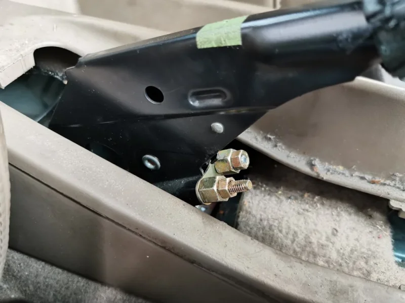

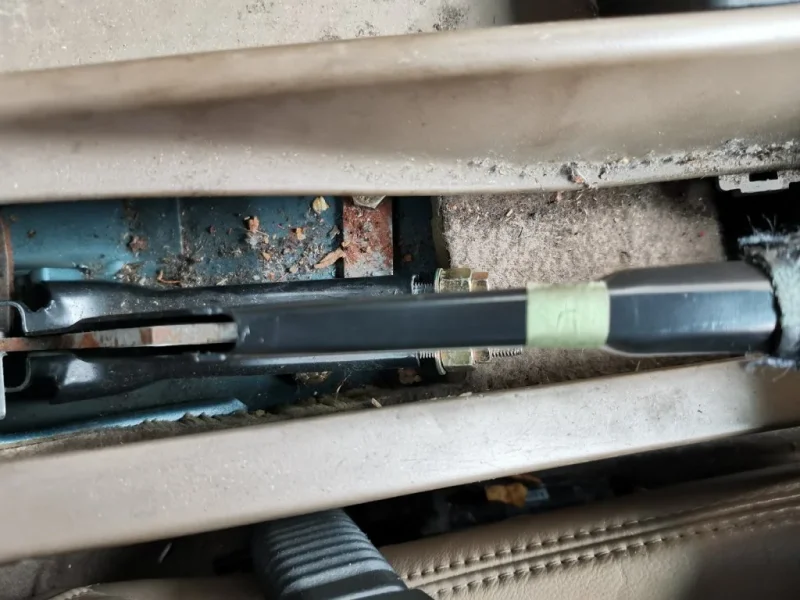

The handle in the car is very loose with no tension whatsoever until it's pulled almost all the way up. I have attached photos of what the bolts look like when it is up and down (first is up, the rest are down). I've never dealt with a handbrake before but am I right in thinking that brass coloured plate should be flush against the black bit even when down? IMG_20191012_140112-1600x1200.webp IMG_20191012_140411-1600x1199.webp IMG_20191012_140337-1600x1200.webp IMG_20191012_140318-1600x1200.webp
I had to drive the car when this first happened and the disc was very hot after a while hence I thought it was a stuck caliper. It squeels while maneuvering but that stops when the car is moving along the road.
When I turn the rear wheels by hand, the passenger side one has a little bit of friction but the driver side (the one that has been squeeling and getting hot) will only move freely by a few degrees each way under my strength. I can hear the squeel when it gets to the point where it won't move.
Any ideas please?
Thank you!
It could be a few things but I would suggest removing both rear drums and checking both sides. Also could be the cable itself sticking.
Hope this helps.
I would tend to think it indicates a seized cable. You may find there is a crack in the outer casing and that's where moisture has got in.
And I would usually expect both adjusters to be around the same position. So he nearside looks suspicious as well as the offside.
If you end up with new cable(s) buy genuine BMW. They are almost exactly the same price as a trip to Eurocarparts and won't need any fettling.
Thank you. I'm thinking that too and a cable doesn't look like a particularly bad job to do.
Just to confirm does anybody think it is the caliper? I stupidly bought a refurb kit for the caliper before thinking about it! I assume that the brake getting stuck after the handbrake has been on being the main sign it's the handbrake and not the caliper.
You can take the calliper off to see if it was that (unlikely), could be cable ( as Rob said check cable outer sheaths for cracks and rusty stains) two other possibilities are seized shoe expander (likely) and/or shoe lining come off one off the shoes and is jammed behind the other shoe (likely) .
You will have to de adjust the shoes to get the disc/drum off.
Looks like seized cables to me, been there had that. Cable outer was stuck in the backplate, had to drill it out, and the other end was well stuck in the tube it goes through above the back end of the prop, just had to be persistent to get it out. As said above, get BMW cables, you don't want to be doing it again next year.

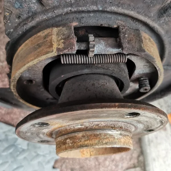

I used some YouTube videos to get the rear disc off - only hard part was persuading the disc off the hub, needed some hammer taps. Was surprisingly easy.
What I found behind the disc was not pleasant...
My hand brake has been used to slow the vehicle when the rear pad material dropped out and was just the pad backing plate left (EBC can be somewhat variable quality I have found out....).
Hence you can see the shoes showing wear - it wasn’t used a lot but they wore out very easily- I not sure they would last long enough to actually get your disc hot.
Perhaps you have handbrake issue and stick calliper (very common).

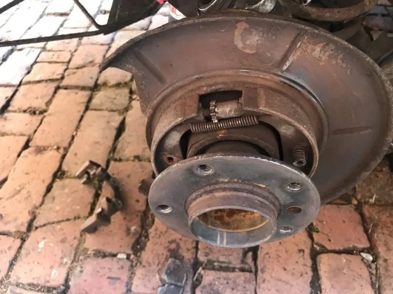

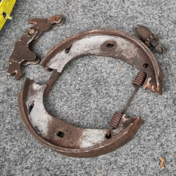

IMG_20191110_193957.webp IMG_20191110_194028.webp I finally found the time and correct tools to take everything off and the cable is absolutely wrecked. All the sheathing near the wheel end must have been ripped for a long time because the cable has rusted. What should the shoes look like? They look alright to me...
View attachment 122481 View attachment 122479 I finally found the time and correct tools to take everything off and the cable is absolutely wrecked. All the sheathing near the wheel end must have been ripped for a long time because the cable has rusted. What should the shoes look like? They look alright to me...
As you have come this far you may as well change the shoes and fixings, clean everything up and a good dose of grease, alco worth scrubbing the glaze off the inside of the drum with some 120 grit sand paper
