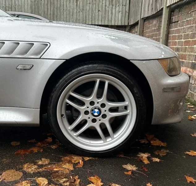

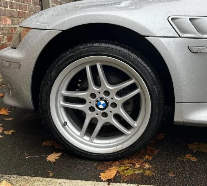

Had front suspension replaced. Initially issue was lower on driver’s side (off side uk) was so low was a problem. Near side was fine. Hence taken to my garage and they advised struts and springs on front replaced both sides. As you can see, now shockingly high and still much higher on near side (1.5”)
garage is a good one and has done lots over the years. They’ve advised to drive it for a week or so and go back. I’ll do that but they seem at a loss as to why it’s higher on near side still. I’d say the only off side is now probably about right but that near side??? Looks like a monster truck. I appreciate it might settle but will still have the issue I went to them with.
They are 18” rims btw.

Okay so a quick update. Thanks for all of your help everyone!
They have replaced the front springs again and all now seem okay?! Gaps are now much more even, maybe 4mm from the two fronts. All lower also. They said they must have used the wrong springs. Annoying but now sorted hopefully.
