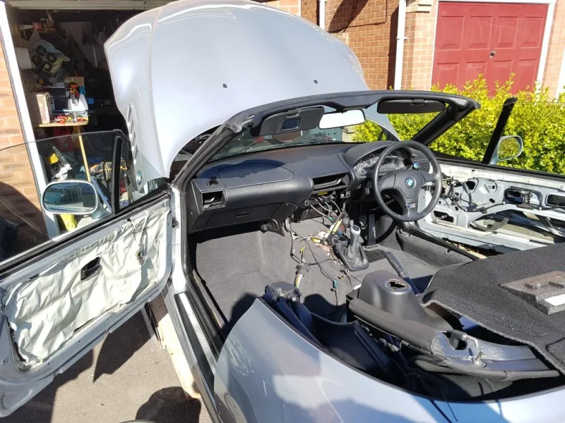

It's the basic 1.9 The condition is pretty good, apart from holes in soft top, rust, oil leaks, major service, electrics, extreme deep clean and I haven't looked underside yet! :(
When I've finished I'll pop over to Swindon, I work in Chippenham, so not far away.
To be fair, if you can get that much of the interior out on your own you look like the sort of person who is going to learn stuff okay. Mind you, you have to get it back again...
I'm very good at taking things apart, putting it back together......is another story. There is bound to be a few bolts left over!
