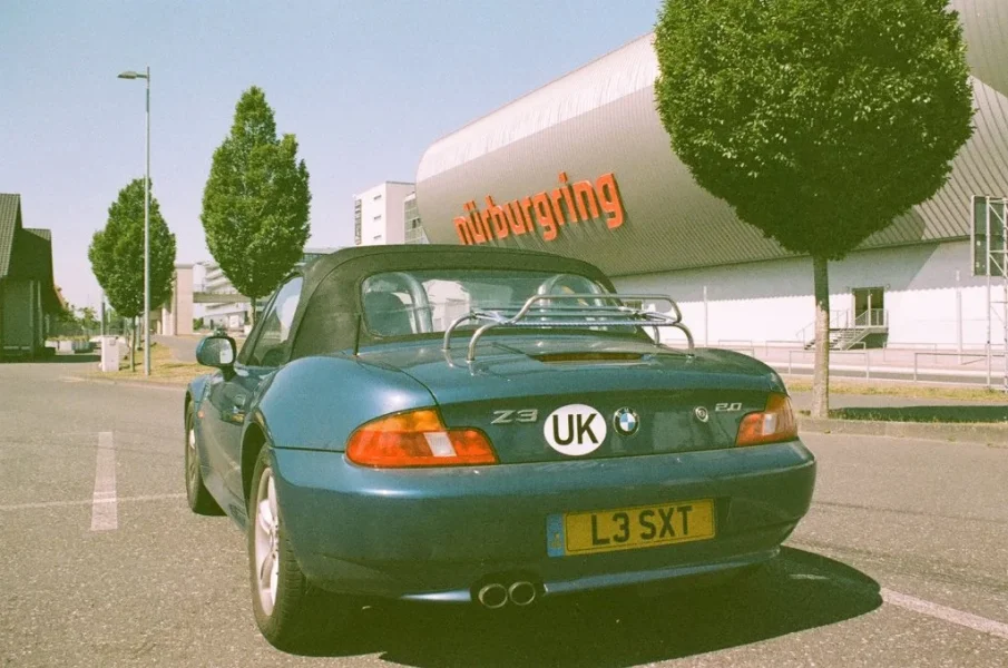

Hello, I’ve just ordered some Eibach Pro-Kit Performance Spring Kit E2062-140, for my 1999 2.0 wonder if anyone can tell me what they are like? And what issues they may of had when it come to servicing, and overall ride hight after fitting. The chap who normally looks after my cars says he’s had issues with getting a lowered z4 on the ramps. Just after feedback from those who have had these fitted! Cheers and thanks in advance! Picture for a bit of fun 😉

Lovely stuff, thanks I’ve got the stock 16”s on mine. Thanks for the advice, she looks a peach!
