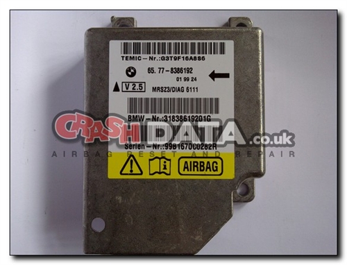

Hi...I believe it is an Airbag ECU.
Part number: 65. 77-8386192
So, guys...anybody know of one for sale with these numbers please..?..I've looked all over but can't find one.
Am I right in thinking: If I get hold of one with this serial number, I just whip out the old one and pop the new 2nd hand one in BUT then have to go and get it coded?
Many thanks.
The part number you quote is the main airbag module fitted to the centre console. Real OEM search on the part number shows a couple of other modules that can be used on your car retrospctively depending on the year of your car. So if you cannot souce one with your part number then look for one of the other compatable units. Replacement will need coding to your car using NCS Expeert otherwise you will have an airbag code and the light set on the dash. https://www.realoem.com/bmw/enUS/partxref?q=65.+77-8386192

I've also found this:
But they say they can only fix certain codes...So I shall have to get the car hooked up to read the fault code once I get it.
The ones listed as ok retrospectively for your car can be used in place of your current one but will need coding to your car when fitted using NCS Expert software.
Crash Data can remove the crash data on a module if its been locked up following an accident, it has to be done by direct reading of the eeprom chip on the circuit board with different software. What code is your current module setting, if its an internal fault the module is probably unrepirable. Best course of action would be to obtain a replacement from the UK and hope its not from a crashed car thats locked it up.

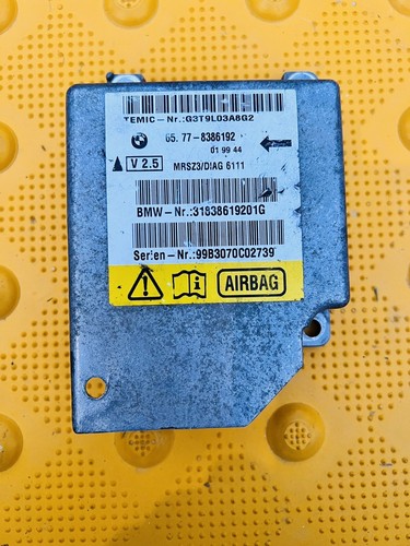

Ok…ECU is out. For my Z3 (1999 1.9) I managed to get it out without removing the central console. Instead I went in from the side but did remove stereo and gauges for help with seeing what I was doing.
A 2nd hand ECU is in the post, with the same number but from a 2.8 2000 model which has not had a prang nor airbags going off.
