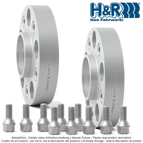

The ones I'm asking about are "bolt on spacers" with TUV papers from Germany. Meaning the spacers is attached to the hub with graded bolts and the wheel attaches to the spacers with the OEM bolts. Similar to how ie some Porche models is delivered with from factory.
Like these ones:
TUV is important, because that means that they are graded to handle the forces in play.
Good to see a example of what you intend to fit.
Oh, they are on the car already. However was hoping to get some real life experience and opinions feedback. I'm there that I think they are safe, however since it so much talk around spacers. I want to be on the "sure, they safe" side of the fence :-)
The type you have pictured use standard length bolts to bolt the spacer to the hub the the wheel bolts to the spacer as opposed to using longer bolts to bolt the spacer and wheel to the hub. Stephen.
Thx, forgot about that one. However I more concerned about handling and safety. (Ok, I admit: I like the look as well:) ).
