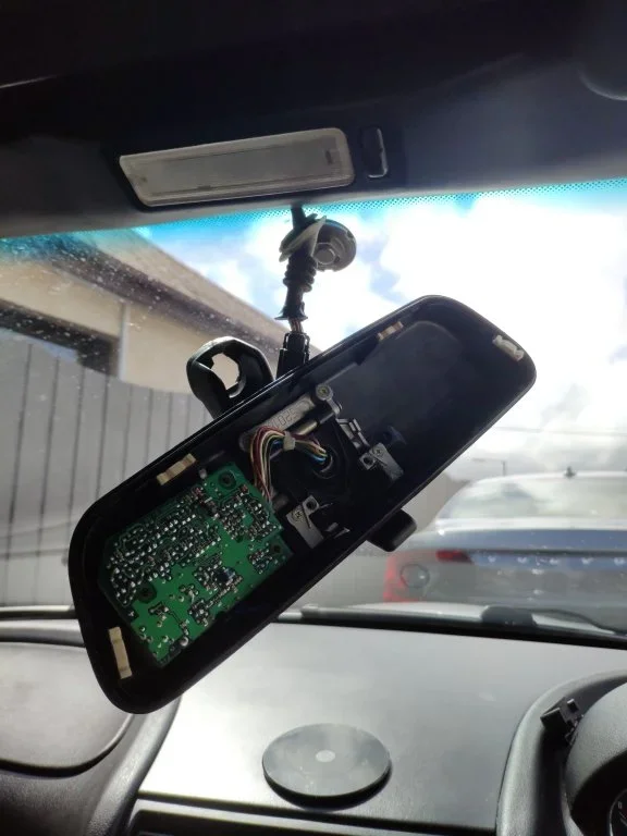

I have the mirror removed from the car and I can see the PCB inside through the hole in the bottom of the mirror but I can't see how to take apart the mirror to look at the insides.
I tried guitar pick around the joint but it doesn't seem willing to separate and I don't want to force it and break it
Update: I got it apart without breaking anything, guitar pick and a bit of force did the trick.

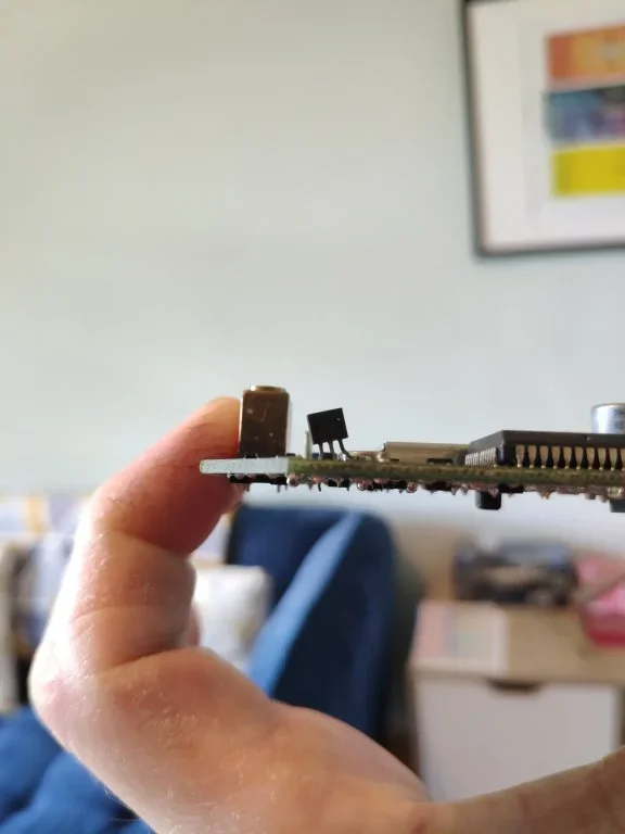

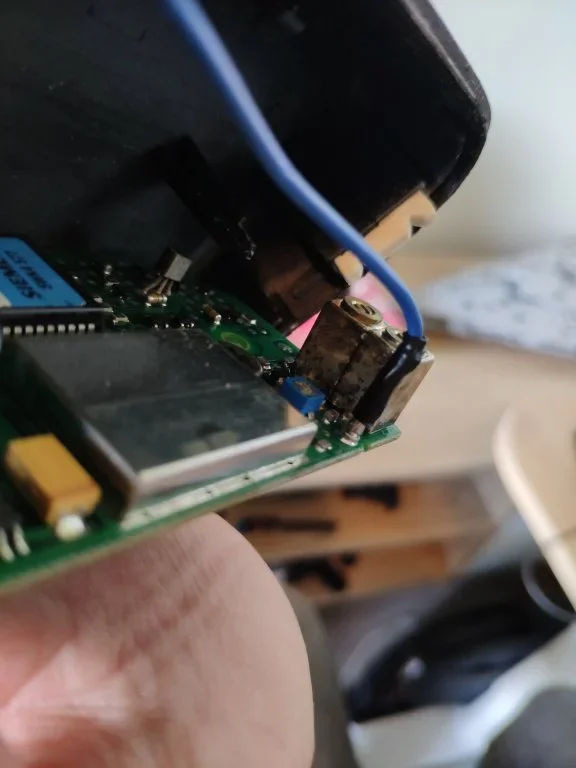

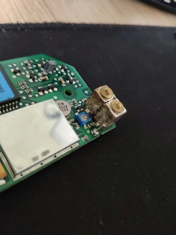

Visibly the PCB and connections all looked fine except for a couple of minor concerns. Some corrosion on a particular component and another component soldered in at a jaunty angle but they looked like they should be okay.
I sprayed with some electrical contact cleaner and reassembled the electrics (minus the mirror front) and fitted back to the car.
