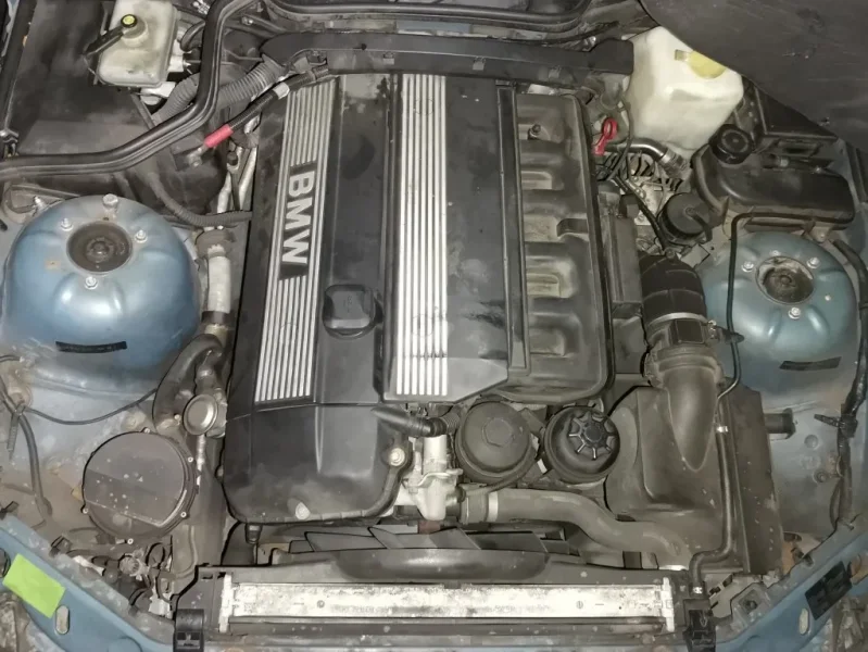

I'll tell you what may sort this. Here's a photo...
Definitely a TU ( technical update) engine.
Twin vanos .
But like said externally the 2.0 tu and the 2.8 tu look the same .

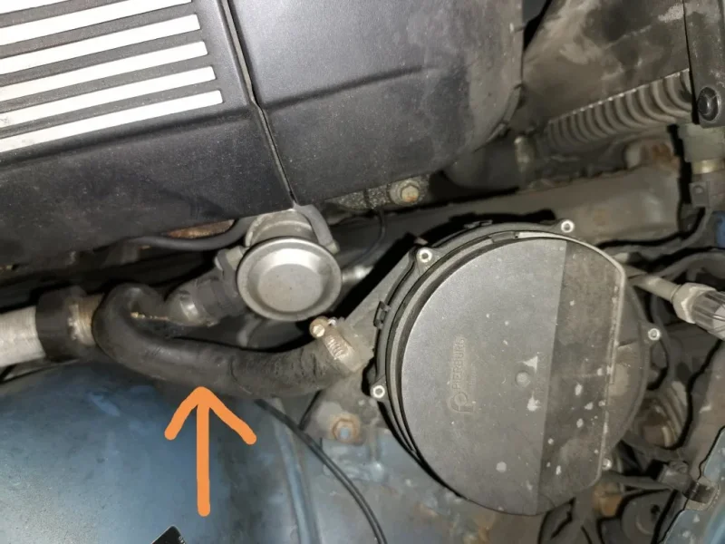

Aside from all this, my original issue was that pipe. Does anybody know what the part number is please? Just to confirm, it's the pipe that goes between the secondary air pump and the engine (a one way valve attached to it I think).IMG_20191114_012353.webp

Aside from all this, my original issue was that pipe. Does anybody know what the part number is please? Just to confirm, it's the pipe that goes between the secondary air pump and the engine (a one way valve attached to it I think).View attachment 122771
Do a smog pump delete, @t-tony makes the blanks
I thought about doing that. Feel free to send me a message with a price @t-tony. I take it the removal does not have any negative effect on the emissions test on MOT.
It's only used during start up for a few seconds
Get a blank off @t-tony and remove it, they are PITA and not required in the UK
