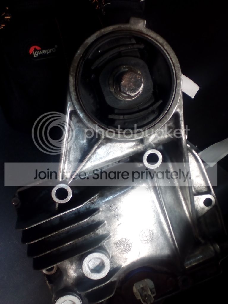

did my own Diff oil a few months ago, and at the same time removed the diff cover polished it, and installed new gasket, and checked condition of diff mounting bush mine was real good looked like new...
