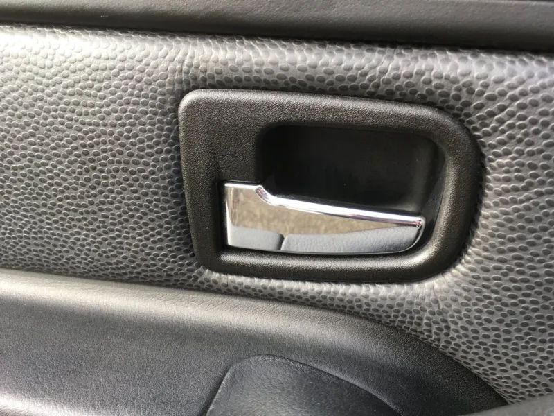

This weekend’s task....colour coding the door handles....
Oh and new door handle seals (perished to say the least)

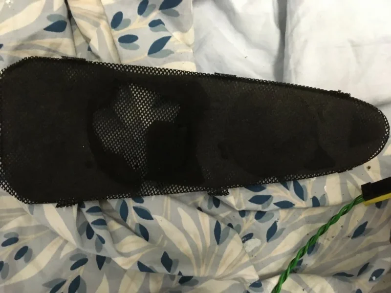

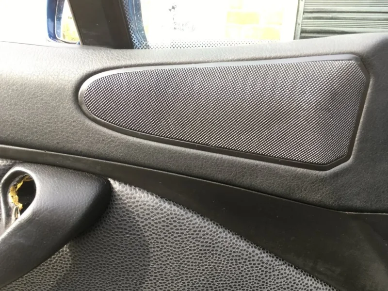

Had some free time today so decided to sort out the tweeter mesh on both sides. So door cards off without breaking any clips :thumbsup:. This is what the tweeter mesh looked like on both sides...
Its one of those things once you've seen it, every time you get into the car you see it!
Replaced the felt backing and resprayed with a matt black finish. Also took the opportunity to spray the interior door handle cover also.

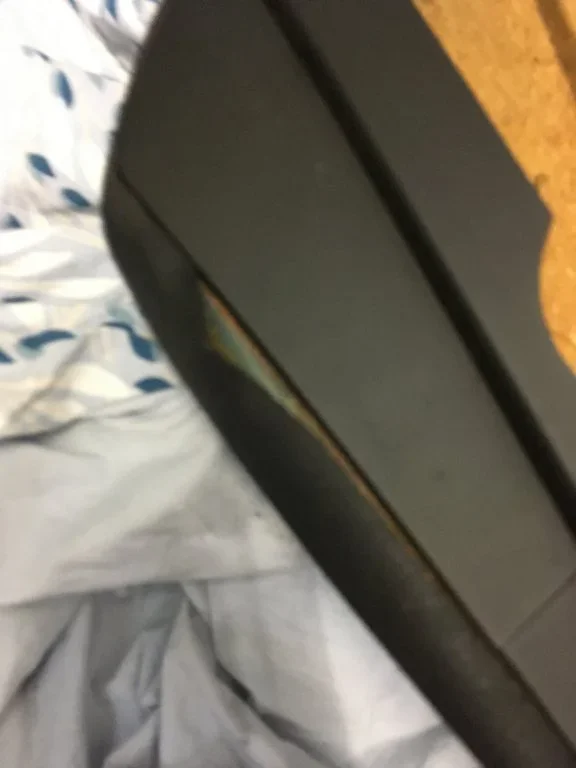

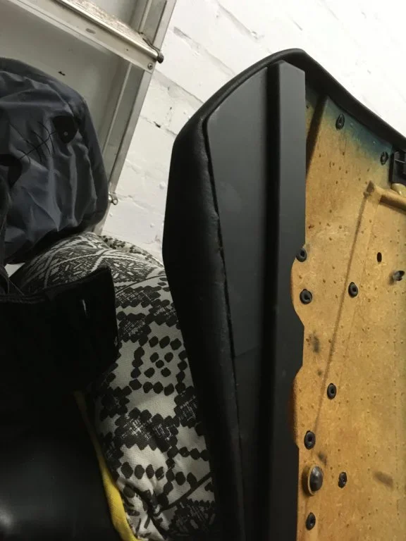

While the door cards were off, i also fixed the leather coming away from the drivers side door card.
Before:
After:
Once the paint had dried, i put it all back together and back onto the car. For anyone who's doing this, I strongly recommend taking the inner window seal off and fit it to the door card before fitting to the car...it makes it far easier to fit.

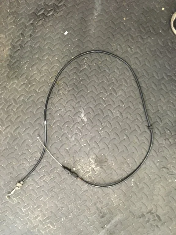

First job was to replace my sticking throttle cable...relatively easy fix. D5226B5A-F459-412E-A219-C824F7DCE8ED.webp
