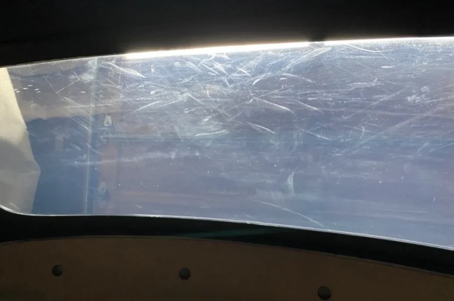

I've done some searching on this forum and have found some posts that recommend applying Gummi Pflege to the rubber seals between the window and the convertible top. My leaks seem to be coming in from where the convertible top meets the window as there is (on purpose I hope) slashes in the rubber probably so the top can fold back easier? I had also seen recommendations to tighten the top and that there is two bolts to do so, but they did not state where these bolts are and how to tighten them correctly. Some water got in overnight while I had my cover on the car (damn cover wasn't waterproof) so now I am parking in the garage as it rains heavy at night here. If anyone has any specific recommendations it would be very helpful, I'm quite the noob on this car and don't know much about it yet! + anyone know the best way to get scratches out of the plastic window in the back? 😄

You can machine polish the rear window with the help and and able bodied assistant. Get them to hold a board wrapped in a towel on the inside of the rear window while you polish the outside, then swap places. I used this product on my Z3. There are several other products too.
Thank you Tony! ~ will look into these products and purchase accordingly.

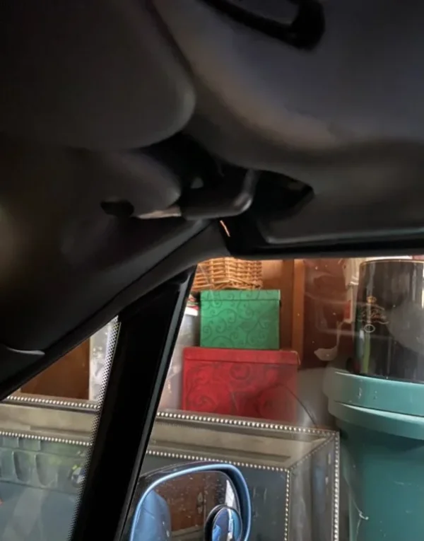

Have you eliminated the `A' pillar seals as your leak source?
What's the best glue/sealant to fill your A (pillar) hole with? :D - actual genuine question though ;)
Take the plug out, clean everything and just use good old fashion puncture repair glue from a bike repair kit to glue it back in.
I use silicone rubber sealant but as @Nodzed says puncture repair glue works. You can check the plug by opening the hood and squeezing plug, if it oozes liquid or you can see a gap then that's your likely leak path.
