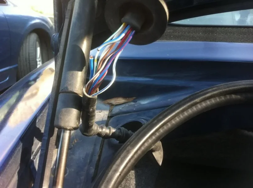

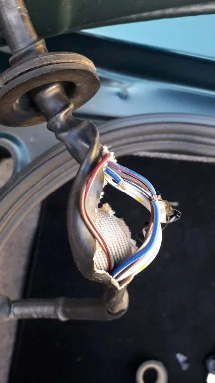

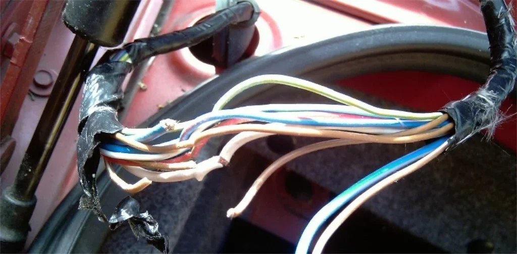

The usual suspect for these symptoms is the wiring loom from the body to the boot lid - aka the `loom of doom' The pics show type of damage that can occur but these are worst case, they can be single wire minor damage. Would suggest you start by peeling back sheath and checking conditions. You can also connect multimeter to lock actuator terminal .
FB922CE8-7996-48BC-82C4-1F13B4891D57_1_105_c.webpD0361822-F13F-48DE-A3A0-3F1E7AD4FEF7_1_105_c.webp
View attachment 140899View attachment 140901
This is what I am thinking too. This seems to be a common occurance. Cheers.
