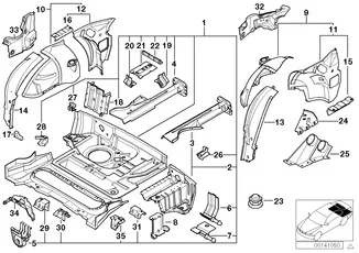

If you type the part number 41112491300 into the search box, it should come up. It’ll say the part won’t fit the car, but it does.
It’s part 35 in real oem photo attached

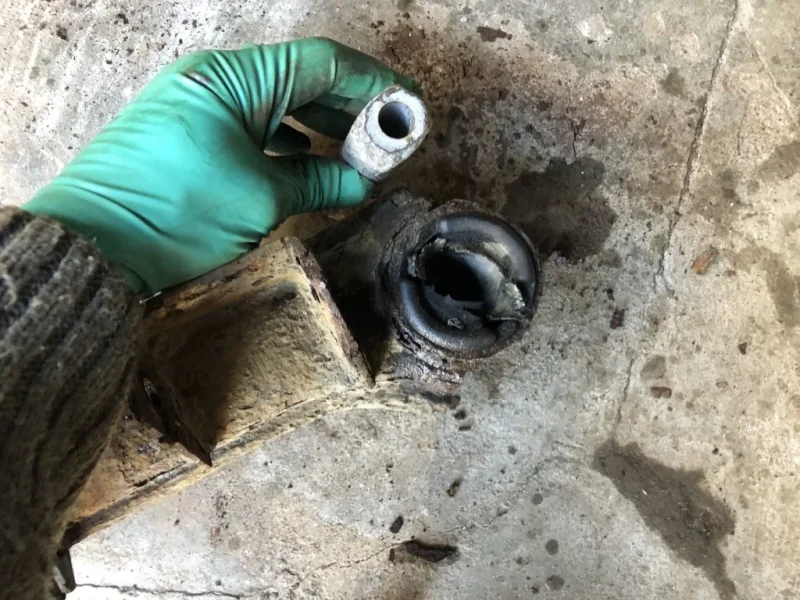

This is what my right rear subframe bushing looked like. The metal insert had completely torn away from the rubber! This seems like the clunk cause.

That would cause a knock/clunk on bumps
