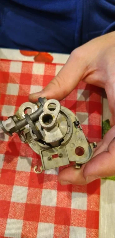

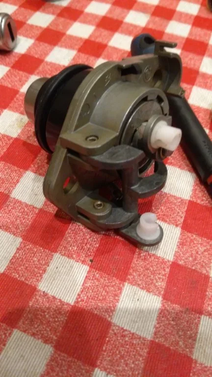

To remove the lock from the boot there is a plastic access panel right behind on the inside of the panel, remove it carefully by prying out and pushing on the sides and it will come out.
Inside there will be a couple of (I believe 8mm or 10mm) bolts attaching the lock to the boot lid, you need to disconnect first two connecting rods that are prised into two white plastic pieces on the lock, you can simply pull them out with a bit of care.

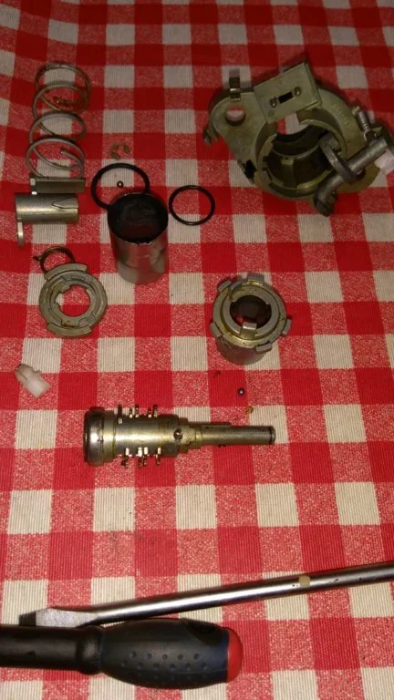

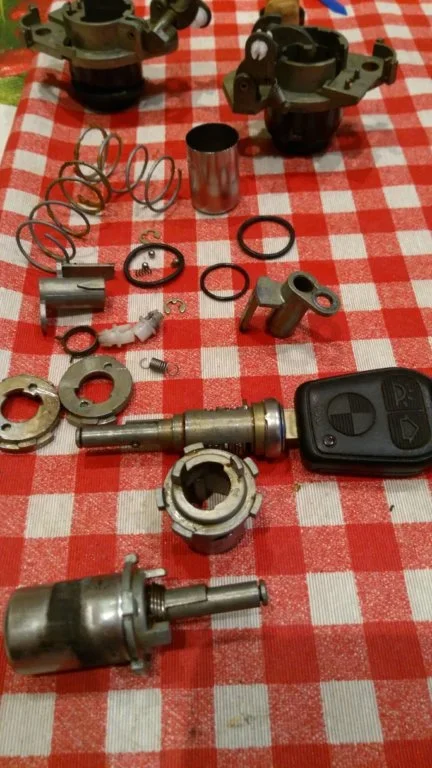

Once you have the lock in your hands you can start the disassembly – note that you don’t need the original keys from the lock to do that at all. I suggest you take pictures along the way to be able to determine how everything goes together when putting it back.

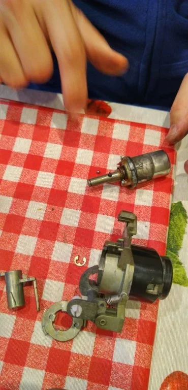

First step would be to remove a circlip that holds all of the parts together which is located at the back of the lock, I did this with the pliers and it was easy maybe you have other techniques.
Second step you can remove the lever/pin plate part that sits right underneath – do this carefully as there is a ball bearing that might come out, mine was covered in grease and got stuck inside, but you definitely want to find that ball bearing if it comes out, additionally there is a spring inside the lock shaft, mine stayed inside but watch out.
Note that on full disassembly you will end up with two small springs and two ball bearings, the ball bearings are all the same BUT the springs are different, take note of which one goes where.
Now there is a plate that holds more of the internals together, the way to remove this is to push in and rotate this plate until you line it up with the cuts on the lock body and it comes out, I did this by pushing with two screwdrivers on the circle notches on the plate while rotating at the same time, there is a big spring underneath that might offer some resistance to you rotating it but keep at it until you have it out.
Once you have that out you will end up with the plate, the big spring and hopefully you will be able to fish the ball bearing and the small spring from the lock shaft.

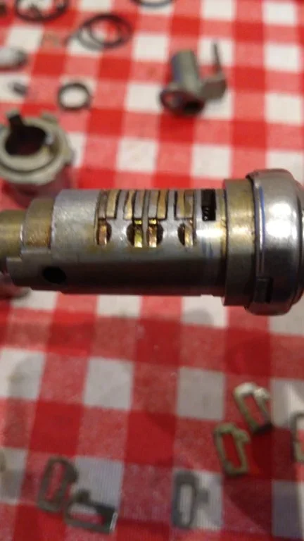

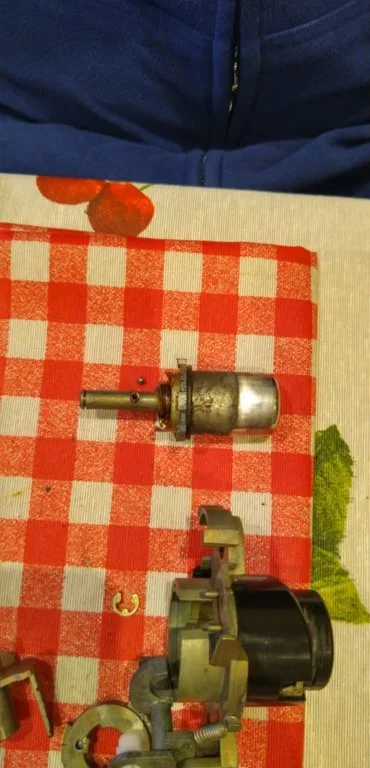

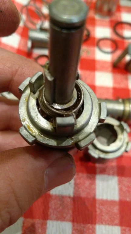

Third step you can slide out the lock cylinder from the lock body, time to clean it carefully and check the condition of the first of two rubber seals on this lock. You can also remove a clock spring that sits at the end of the cylinder/tumbler.
The fourth step would be to slide out the chrome sleeve out of the tumbler, the way to do this is to very carefully wedge a thin screwdriver between the chrome sleeve and the lock tumbler body right where the rubber o ring was and prise gently. Carefully work your way around it being careful not to damage that part or you won’t be able to slide it in again later, patience is your best tool here, and maybe some lubricant and it will eventually slide out.
There is a rubber o ring that seals the lock cylinder with this chrome sleeve, located at the bottom lip of that chrome sleeve
Once you complete that you need to be careful here, this is where the lock tumbler slides out of the cylinder and all the parts come flying if you are not careful.
Slowly push it out of the cylinder while with your fingers you stop all of the pin plates from flying out – there is also a ball bearing and a spring, in retrospective if you complete this step by doing this part with your hands and the lock inside a clear plastic bag so you can see what you are doing that will help you avoid losing any parts.
Congratulations !! if you have made it this far you have completely disassembled the lock ! and that was the easy part J

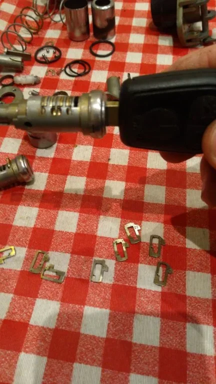

The way to match the lock to the key is quite simple, you will see that those pin plates are numbered on one side, the idea is that you try your existing key with the donor lock and starting on one side you see which pins sit flush with the tumbler when you put the key in (note that you will have to push the pins inside a little bit with your fingers to help the key go in) and make a note of those and then focus on the pins that stick out.
For the pins that stick out you start a bit of trial and error – note that the “arrow shaped” pin will always stick out no need to touch that one – say on the first position you have a number 9 plate and it sticks out on one side then you remove the key and slide a number 10 plate in that position and put the key back in, if it sticks out even more then you do the opposite and try with a pin 8 plate and hopefully in a couple of tries you can make that plate sit flush, keep repeating this with the rest of the positions in the lock tumbler. Note that plates go in from opposite sides of the tumbler in an alternative way, note also that there are small springs inside to push the pins out, don’t lose them, they normally remain in position with the lock grease.
When doing this trial and error be careful that you keep the plates from falling out when you are inserting or removing the key, or you will have plates falling all over and will have a problem remember where they were unless you are making notes of which number plates go in which positions as you go.
If you have decided to buy a lock repair kit you should have plenty of plates to match your key, if you have not and you are using plates from donor locks then you might not have enough plates to do a perfect match, in that case what you can do is file the plates a bit until they sit flush, you can test this by inserting the lock with the key inside into the lock cylinder and see if it would rotate 180 degrees very smoothly, if it doesn’t then you haven’t matched properly and you have plates sticking out and need to do some filing / grinding.
Note that I don’t recommend you go crazy with the filing or you might remove too much material and weaken the plate, do this only to go a number up or down – i.e. you need a number 8 plate but you only have a 9 or a 7, put it in the lock with the key inserted grind the excess material until the plate sit flush and see if when you insert the tumbler in the cylinder it rotates 180 degrees very smoothly. We are talking about maybe a tenth of two tenths of a millimetre here that you need to remove.
There is an “arrow” shaped plate – that remains where it is and does not need to be touched – you push that arrow down to fully insert the tumbler inside the lock cylinder.
Once you have everything matched is time to clean everything the best you can (especially if you had to do any grinding) and lubricate for reassembly.

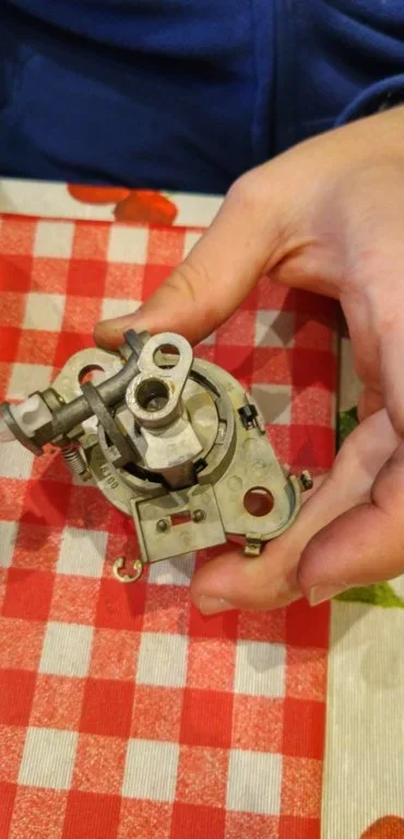

Super fiddly final step four – this took me a few tries to get right, and things might/will come flying !!!
Let me try to explain this the best way possible J
Familiarise yourself with the way things go back together first, you will need to put the big spring and then the plate that you rotated out alongside the lever pin plate sitting on top, it only goesbacl in one position so you can push it all the way in to the point that you can rotate the circular plate, note that the pin plate that sits on top goes has a cylindrical part that goes over the hole where the ball bearing and the spring were located, this is the difficult bit.
Once you have done a few tries you need to get SOMEONE to help you because you will have both hands holding the lock assembly from each side with everything slid together to the point where the hole is still visible while that person carefully puts the spring in the hole and the ball bearing, then get that person to push the ball in with a flat screwdriver from an angle across the big spring while you push the two parts of the lock together so the cylindrical part of the plate pin part goes over the ball bearing and keeps it inside. It will take you a few tries but keep the faith.
If you are lucky enough to have completed this successfully, keep holding it together and rotate the circular plate a bit, then once its holding everything together you can relax and rotate the plate to the right original place all the way.
And you are almost done! All you need now is to put the circlip back where it was and test the functionality of the lock, you should feel the notchy operation when rotating the key and also when rotating the “pin plate” arm you should be able to feel also a notchy action at the ends. If the key does not rotate 180 at this point or the arm does not rotate 90 degrees then you need to rotate the circular plate a bit more.
