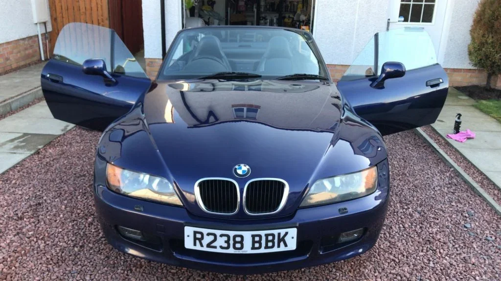

Emissions issue now "resolved", well I have an MOT thats valid.....I'll leave it at that.
Now to work my way through the list of advisories and learn how this little beauty works!
