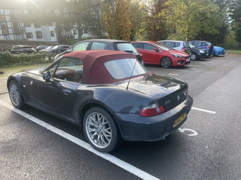

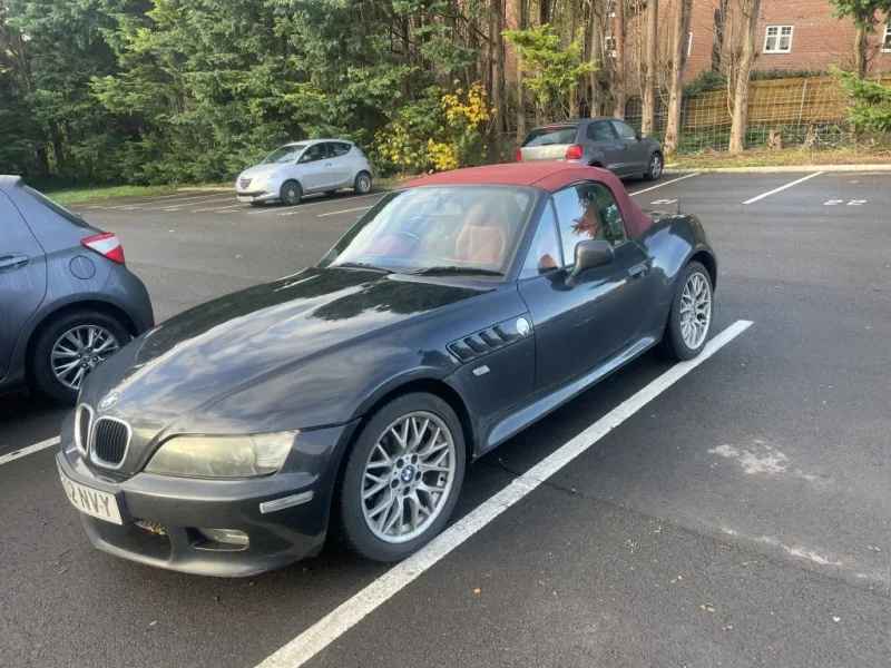

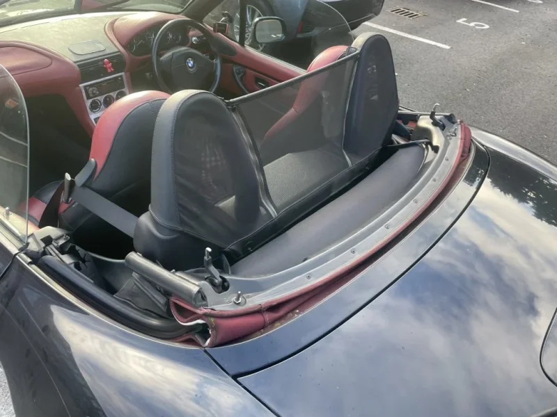

I've got her back from my local BMW specialist and snapped a load of photos this morning. This shows how she looks after an autumnal round trip to west Cornwall (and not a half mile trip to the car wash!). Plenty more photos available for those of you so inclined. She has a toolkit, warning triangle and after-market Pioneer radio with USB port, although the speakers are awful.

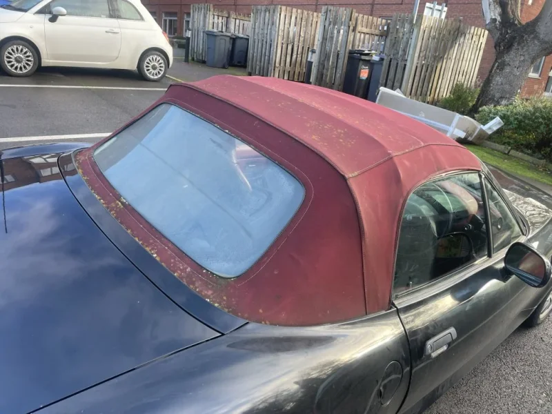

  • There's obviously lichen on the roof.

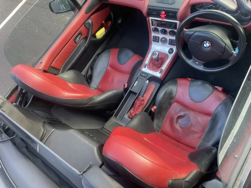

  • Stain on the driver's seat which pre-dates my custodianship. Probably a former owner letting too much rain in.

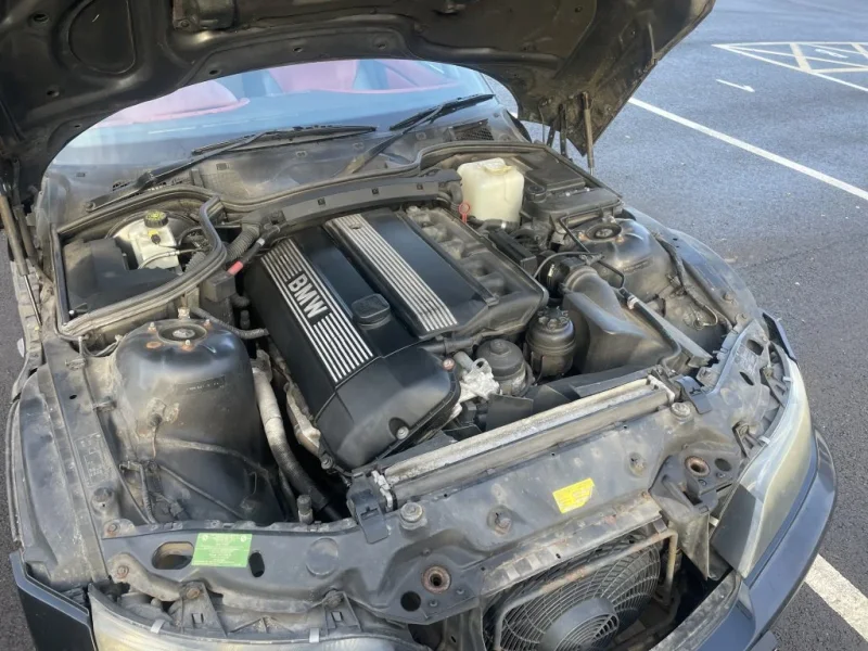

  • Minor oil leak from what I think is the rocker cover.
