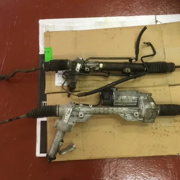

Without an engine to power the PAS pump you'll struggle to steer it. I've got a 1 Series electric rack that I keep falling over.
Not much. I'll swap it (plus a few $$) for an M44 if you get stuck with it. There's no rush tbh.
What I can do is dig out out again and compare it with a Z3 rack, mainly the distance between mounting points. Modifying the crossmember wouldn't be hard. The rack has done about 40k from a 2009 116i.
Here is a Z3 rack next to an electric rack. The distance between the original rack mounting holes is 234 mm, on the electric rack it's 302 mm so you'd need to cut the mounting lugs off the crossmember and refit them.
