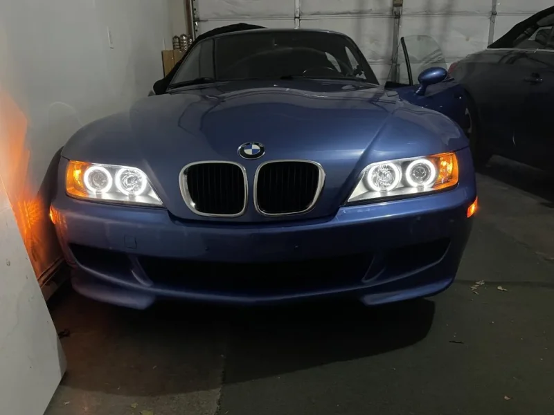

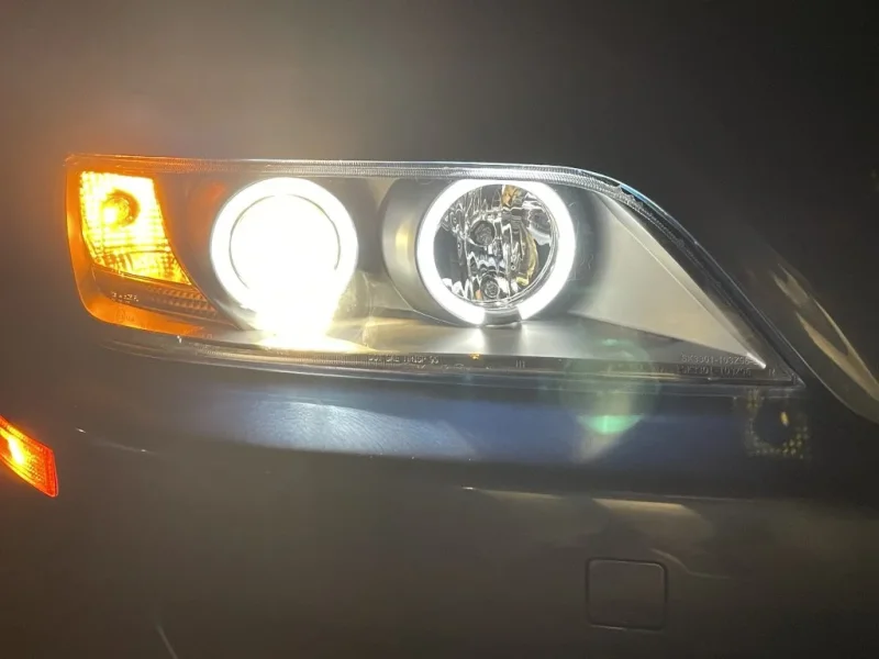

I had a similar set of lights and wasn't entirely happy with the look although as you say brighter. I opted to buy some old lights but with glass lenses, swapped the orange indicators for clear and fitted a set of Zedonist angel eye DRLs. I much preferred this option. Especially with brighter bulbs.
I got some complete headlight units from Amazon recently, complete housing with xenon bulbs, projector beams, and LED Halo ring lights. The inside of the units behind the clear lens is black, and it looks very good. Not really expensive either. About $200.
I wired the halo ring lights into the wiring that lights up the front side marker lights, so that the halos light up whenever the side markers come on, even if the headlights are not on.
The previous owner had put in some HID retrofit ballasts that I had to remove. They drilled holes and used zip ties to hold the ballasts in place, but it was all not working and was messy. This solution works well.
