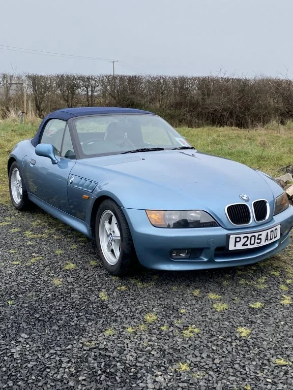

Hello all I have joined this forum for my love of the Z3 but also on a more annoying note nobody seems to know what is wrong with my 1997 1.9.
It started to lose power and as it it lost power the induction got louder and louder until it eventually was bogging down anytime I gave it over 10% throttle (basically limp mode)
I have had a couple of mechanics to have a look but they are stumped as to what it could be. It is running on all cylinders and the air filter is all good.
If anyone has any ideas or experience with this problem I would greatly appreciate it. Thanks for reading. 0FC199D9-B27C-4603-B827-1D5248093ACF.webp
